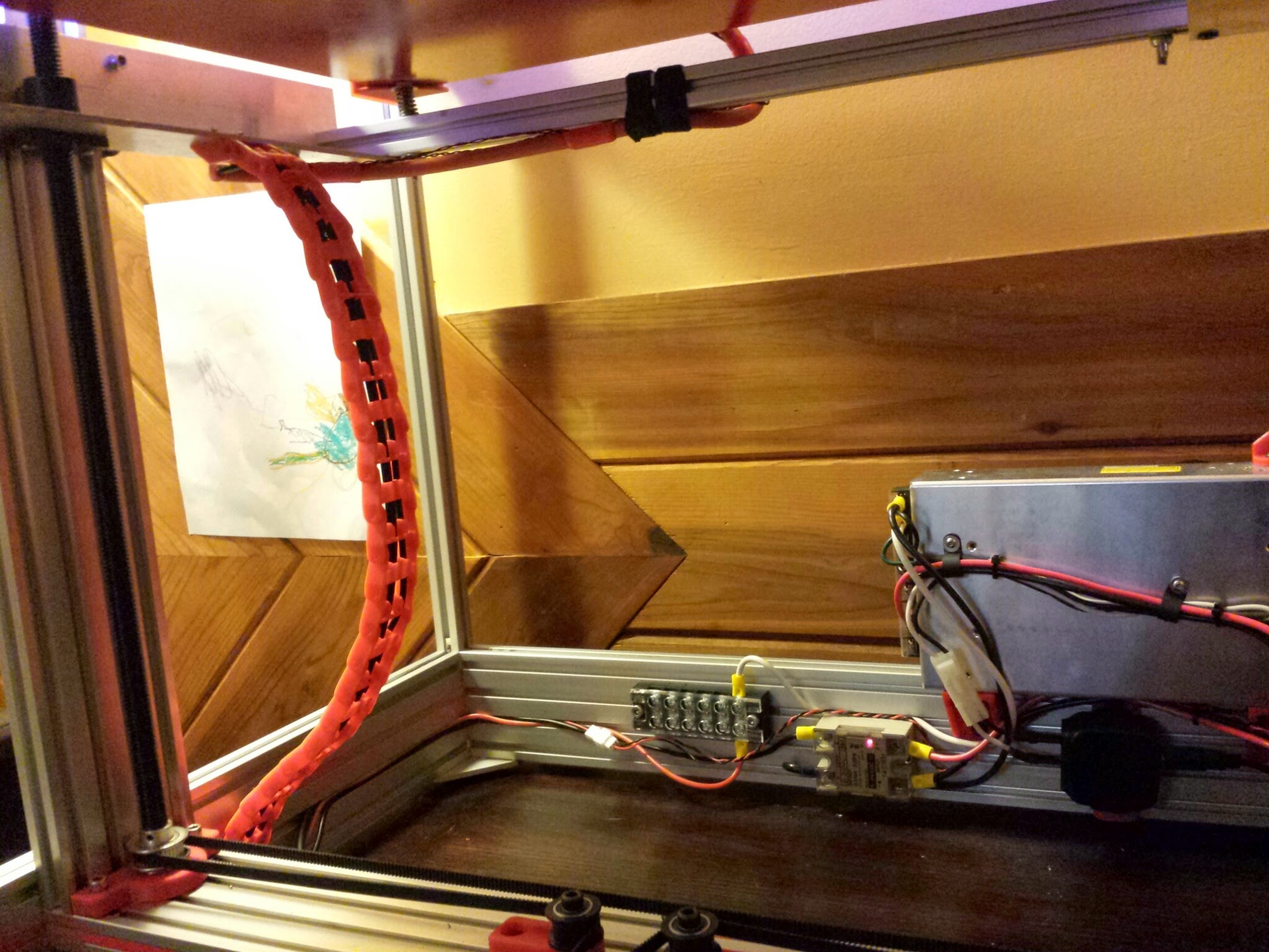

Finally getting around to a little wiring cleanup after my 120v/800w/SSR heated bed upgrade a while back. The printed cable chain worked surprisingly well (a little dab of superlube at the link joints make the motion smooth as butter).

@Joe_Spanier the model number is in the BOM, but it is a 20a omron (watch out for knock offs). Since it is a 800w 120v heater the amps draw is only a fraction of the 20a capacity.
@Eclsnowman Do you have a link to the cable chain with the modified bottom link as it looks good and will clean up the power connection to my #HercuLien heat bed? I looked through the #herculien files and could not locate it.
@Marc_McDonald fyi you have to remove the orange outer silicone installation through the cable chain because it won’t fit the one Large cable. But it removes easily.
