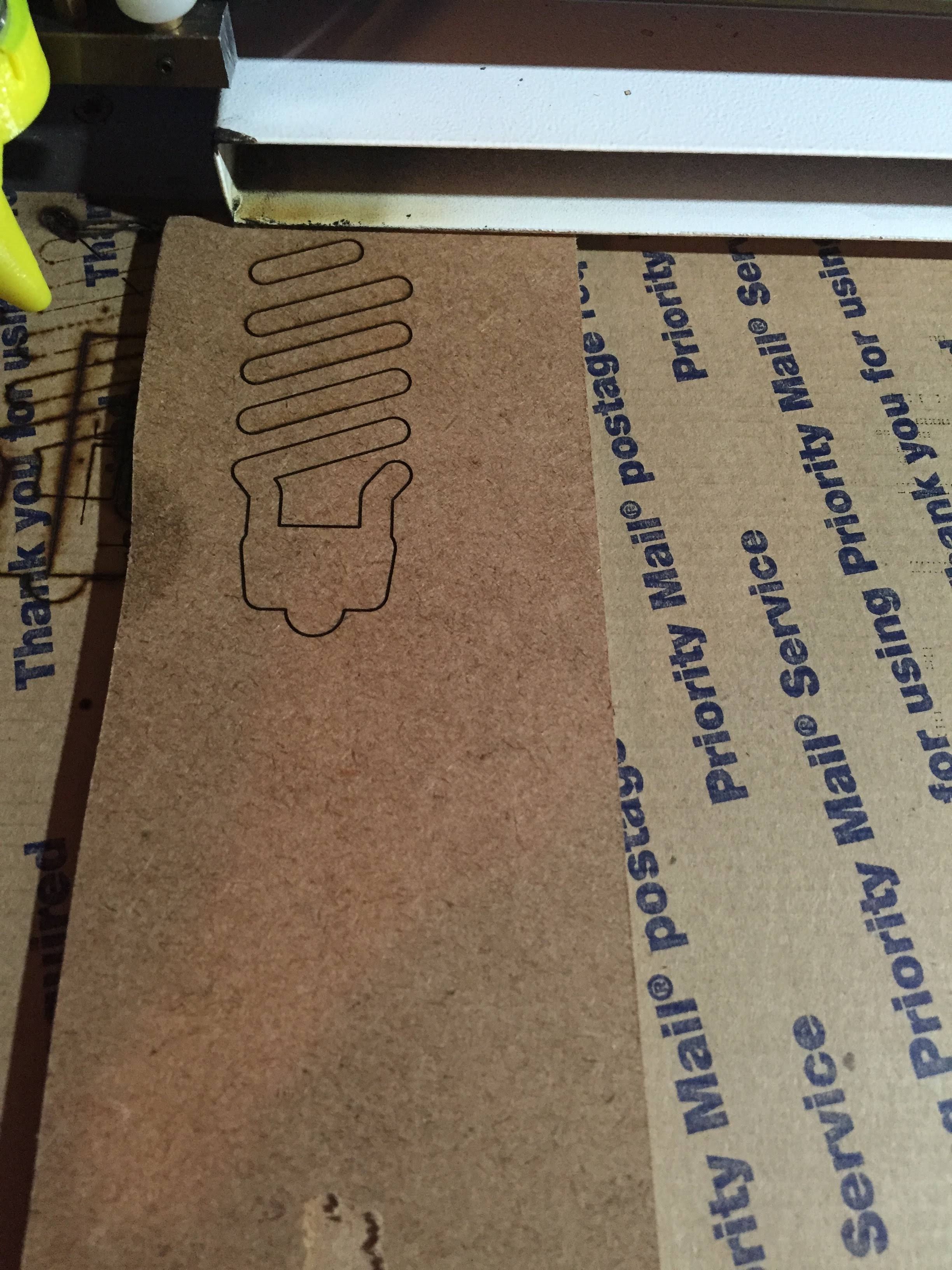

Finally got a good engrave. That's 20% power to the tube.
Finally got a good engrave. That’s 20% power to the tube. Word of warning, do not use the latest smoothie edge firmware with lasers. Pwm is broken there and will always run at full power. Arthur posted about this a while back, but in case you didn’t see… The June 26 build, which is what’s on the master branch is the “latest” that you will want to use with laserweb.
Do a raster
