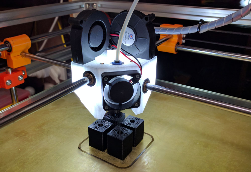

Finally got around installing Walter Hsiao 's mini space invaders carriage,
Finally got around installing @Walter_Hsiao 's mini space invaders carriage, while redoing a few other bits and pieces. Such a great upgrade!
Looks great. Plus you can actually see the first layer. I have thought of doing this myself. I already have my HercuLien, so I can easily handle the small loss in X/Y travel. Plus it just plain looks cooler than my design, in addition to the extra cooling.

@Eclsnowman I need to double check, but it seems that I have actually gained some room on the Y axis and lost nothing on X. Visibility of the print is much better, though a bit limited by the angle you’re looking from. The lights really help!
I’m trying to decide if I need this mod. I can’t work out where the LEDs go. Also what are the holes directly under the bearings for? I assume they’re vent holes? Can I get away with using 4010s fans?
Has anyone tried this with the stock leadscrews? Walter says it might not work because the hotend sits a bit higher. Can anyone confirm?
@Eugene_Lee the LEDs go in the two rectangle shaped holes on the back sides, I could just push them in. The holes under the bearings must be for ventilation, although there’s not that much air coming through. I used bog standard fans from AliExpress.

@Oliver_Seiler Thanks a lot! Yes more pictures would help. Still a bit confused about the LED, do they face inwards so that they illuminate the entire carriage? That means you would have to use transparent filament.
Sorry, when i said “4010s” I should have said 40mm blowers (instead of the 50mm walter uses).
On a separate note, is it worth moving from lead screws to ball screws?
@Eugene_Lee printing in transparent or translucent filament would make sense, except when you plan not to use the LEDs - but I find the lights really handy (and they look cool).
I use 50mm blowers on top - I guess you could use smaller ones if you could fit them into the holes - but why bother when you can buy them cheaply?

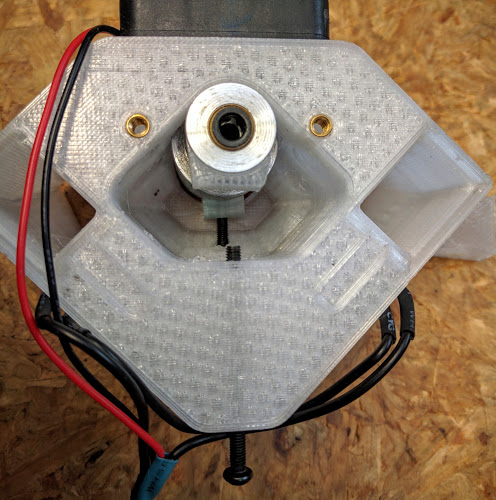

Did some printing ahead of time and decided to print out this mod. All the parts came out great and bushings align perfectly. I’m having a hard time working out how the E3D hot end is held in place.
I’m not sure if I need 6 inch (exaggeration) screws, if my screw holes didn’t turn out right, or if I’m supposed to drill out the holes to a certain depth.
For anyone who has this mod, what size screws did you use to hold the hot end?
Do the screws just press the small pieces up against the hot end heat sink?
Yes, you will need long screws (don’t drill out the holes) and have them press against the two little parts. At least that’s what I’ve done and it works fine;)

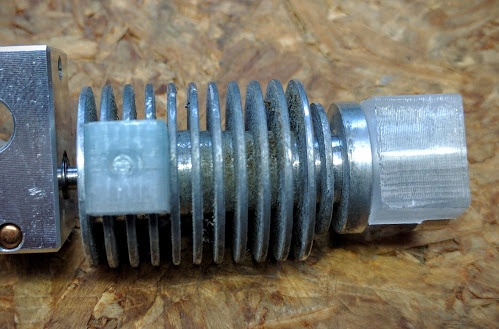

I have made a slightly different lower holder that links into the fins of the E3D making it a little less fiddly to hold in place.
Make sure the lowest fin of the E3D aligns with the bottom of the carrige when installing it - if it’s a little too high or low then the hotend gets slightly misaligned.

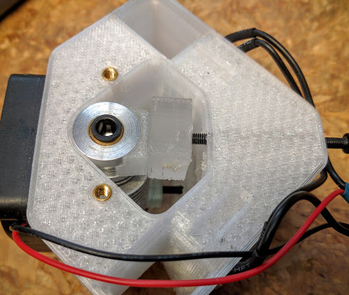

I’m using 40mm screws but you can see the that the upper one is too short and I’ve wedged in a little block that I had lying around from a test print. Hope the photos help.
Perfect! Thanks.
