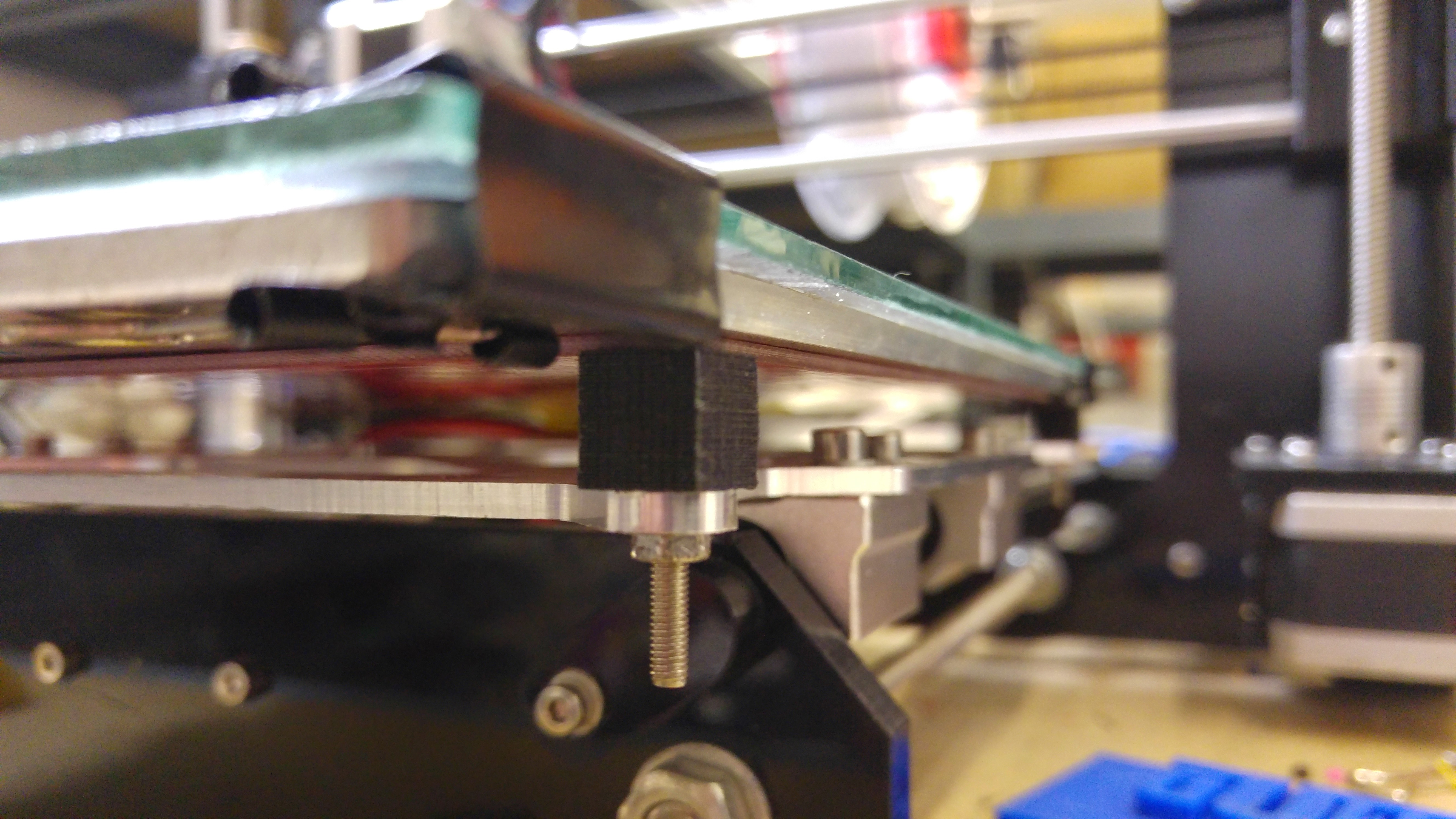

Finally got around to clamping the beds down on my 3 Migbot Prusa i3’s. 5 min design in OpenSCAD and a 50 min print for 12 and it’s made the auto levelling finally behave. It was overcompensating on all three on the back left corner, causing all 3 of them to print badly on full plate prints. Why the hell didn’t I do this before?
