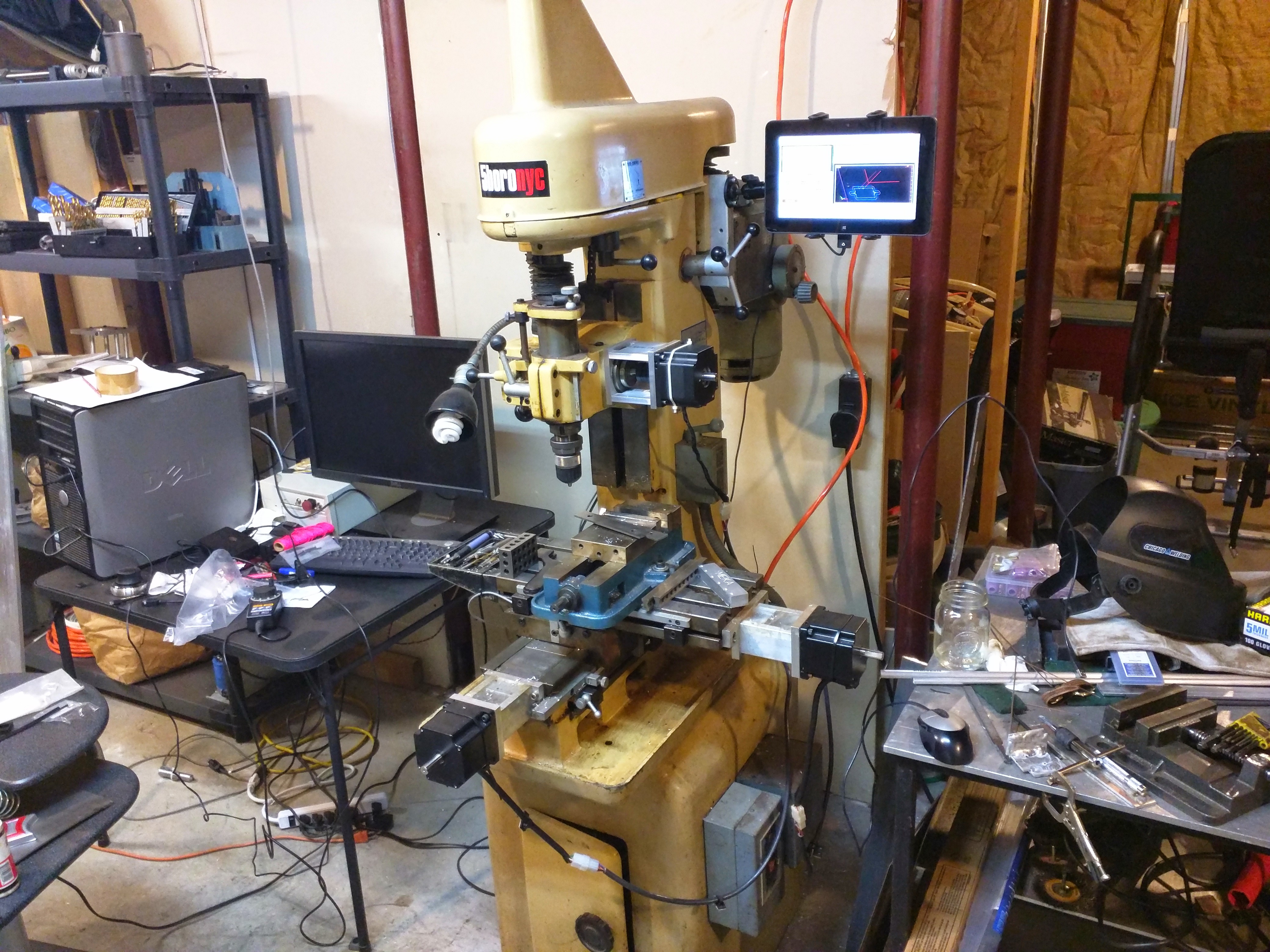

Finally got around to mounting my tablet/control to my mill.
Finally got around to mounting my tablet/control to my mill. I need to find a good touch screen friendly screen set for Mach3 now. Any one have any they want to share?
Great work
Somehow steampunk, love it :slight_smile:
So are you running mach3 on a windows tablet?
Yes running mach 3 on a Windows 8.1 tablet. Kills two birds with one stone. Computer to run Mach and provides a valid Windows license on the cheap. Picked up the tablet cheap on ebay.
so are you using hardware stepping through a smooth stepper or something? I live in the linuxcnc world sorry lol.
Yes I am using a usb kflop controller.
Screenset 2010 for mach 3 is quite good when you learn to use it.
Could you descripe your setup. Mach 3 on windows 8 sounds very interesting if it’s stable. …
Running Mach 3 on Windows 8.1. This is connected to a kflop motion controler via usb. Works good.
Ok. Great info. Thanks.
