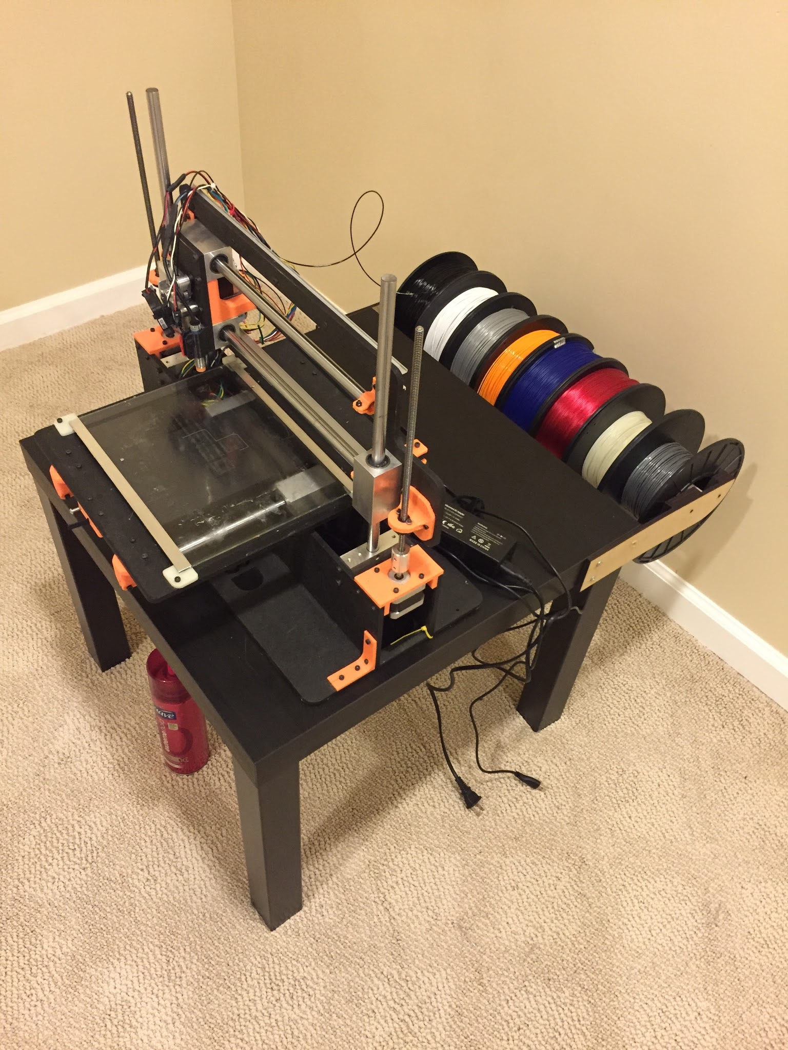

Finally got around to moving my printer.
Finally got around to moving my printer. I bought a cheap table from ikea $10 and laser cut a spool holder system for the back with 550mm 1in pvc. Needs to be painted but I love how it looks/works.
This is the franken-printrbot right?
@ThantiK yup! One of the 34 we are building at my school. Other ones not done yet but will be be same design

@Tim_Sills I go through about a kilo a week with 3D hubs right now. I’m terrible with not taking care of my filament. I’ve never sealed it in a year and a quarter but I still have my very first roll and printed with it the other day. Seemed fine but you are right I need to store some. I just shoved some rolls on there to make sure it could take the force.
Do you have a direct drive or bowden, do you have issues with recoil with the filiment going over that distance
@Grady_Parker its a direct drive setup. I have had no issues with it. Haven’t run it a lot how it currently is but it isn’t that much different in terms of filament placement to how it was before. I used to have a spool holder under the back side of the table.

Tip: These tables from IKEA (we have about four of them, EU version) are not rigid enough for the base of the printer (hollow, very light structure). You will face X/Y resonances after some time. At least mount some additional corner braces between legs and plate.
@Tinkering_On_Steroid my thought exactly
@Tinkering_On_Steroid not sure what you mean. Are you talking about counteracting sag?
