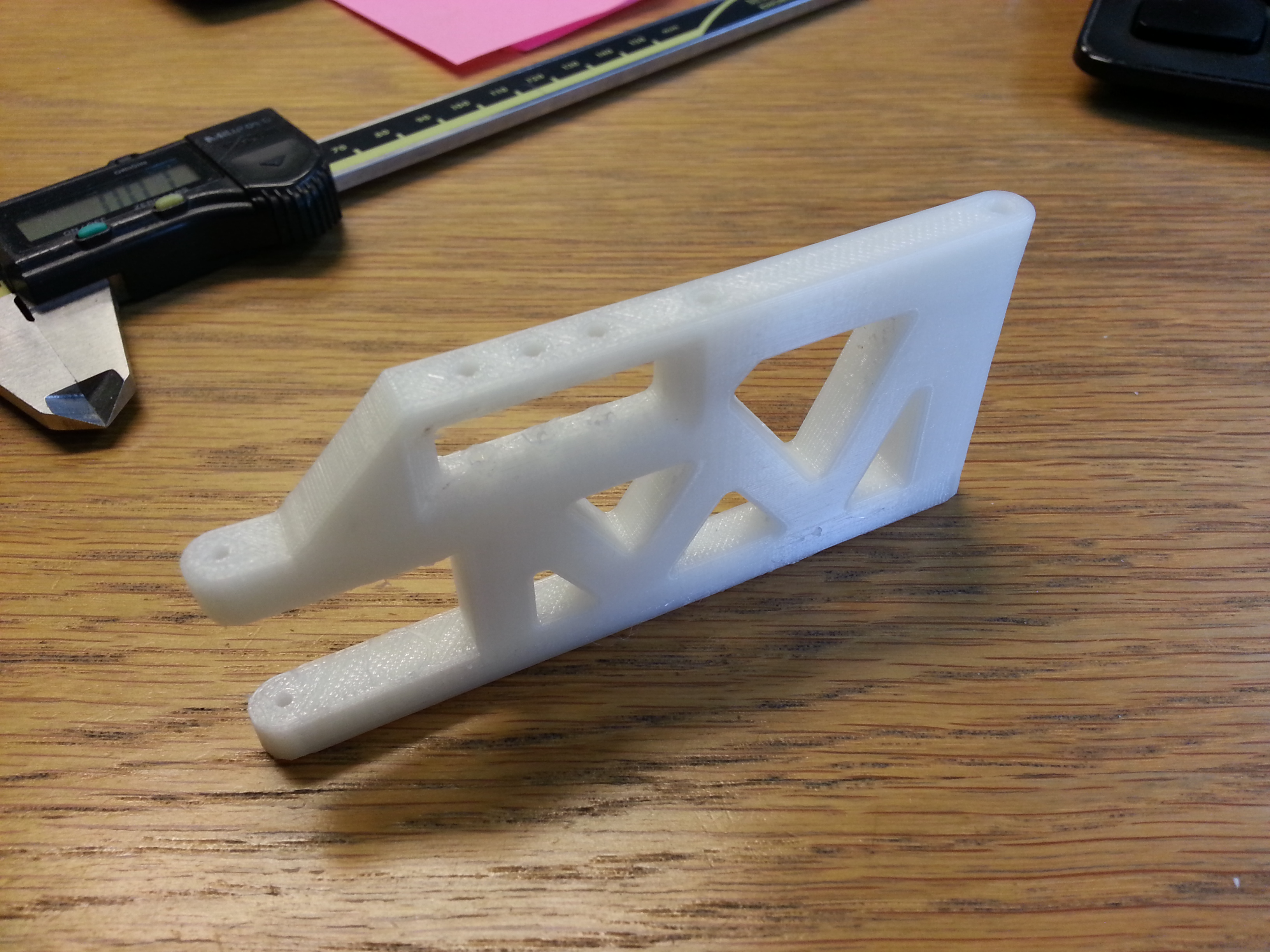

Finally got around to print the wishbones in 618 nylon. Let’s beat the crap out of it!!!
looks nice! What heat settings are you using? extruder, plate. And what surface are you printing on?
@Ted_Backman Extruder @242°C , plate @room temperature and it’s printed on a Garolite plate.
