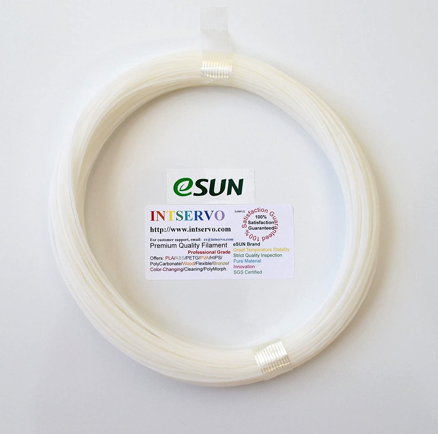

Why would it being charred ruin it? I’ve had my hot end charred, and I used some esun cleaning filament to clean it up.
Another alternative is to do cold pulls with nylon: nozzle-cleaning [Bukobot 3D Printer Instructions & Docs]
@dhylands wrong thread?
@Riley_Porter_ril3y I don’t think so - replying to the last comment by @SirGeekALot (at 16:48) about his charred hotend.
Oh i see. Cool.
@dhylands I went ahead and ordered some of that cleaning filament. It is cheap enough to give it a try.
