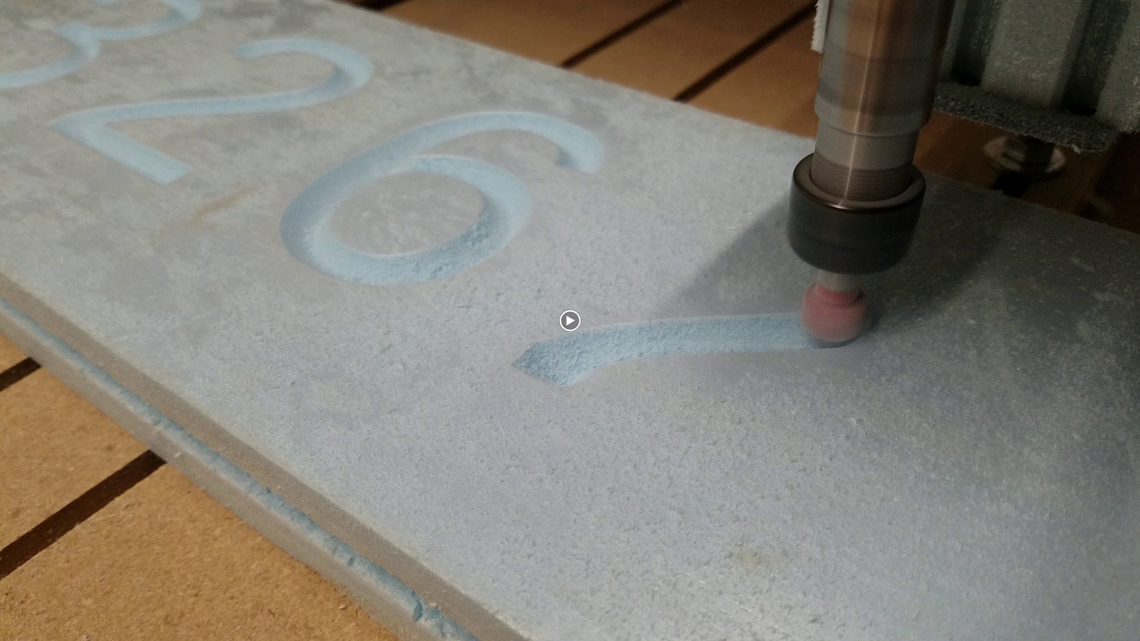

1.) A house address sign for my son!
2.) A name plaque for my grandsons new bench
Design software: I used F-engrave to design the lettering and found it pretty easy to use and works quite well.
OX driver /TinyG: Chillipepper
Material(s): Fiber board for the “Zeke” and insulation Styrofoam for testing
I will be routing the sign in redwood today!
I love routing this foam its a great practice material. I don’t recall where on the web I stole this idea but it works awesome and its pretty cheap ($10 for a 2 x 4 sheet).
I used 3/4" foam and routed a slot in the side for the work holding so that it eliminates interference with clamps at the surface.

I really like the work hold down. The foam is amazing at running code on.

@Kelly_Burns , Don has it right on. This is the material that I will lay out things, that I want to spend time on. Things with multiple tool changes, including fine detail 2mm ball end work.
Highly advise it for your V-carving experience.

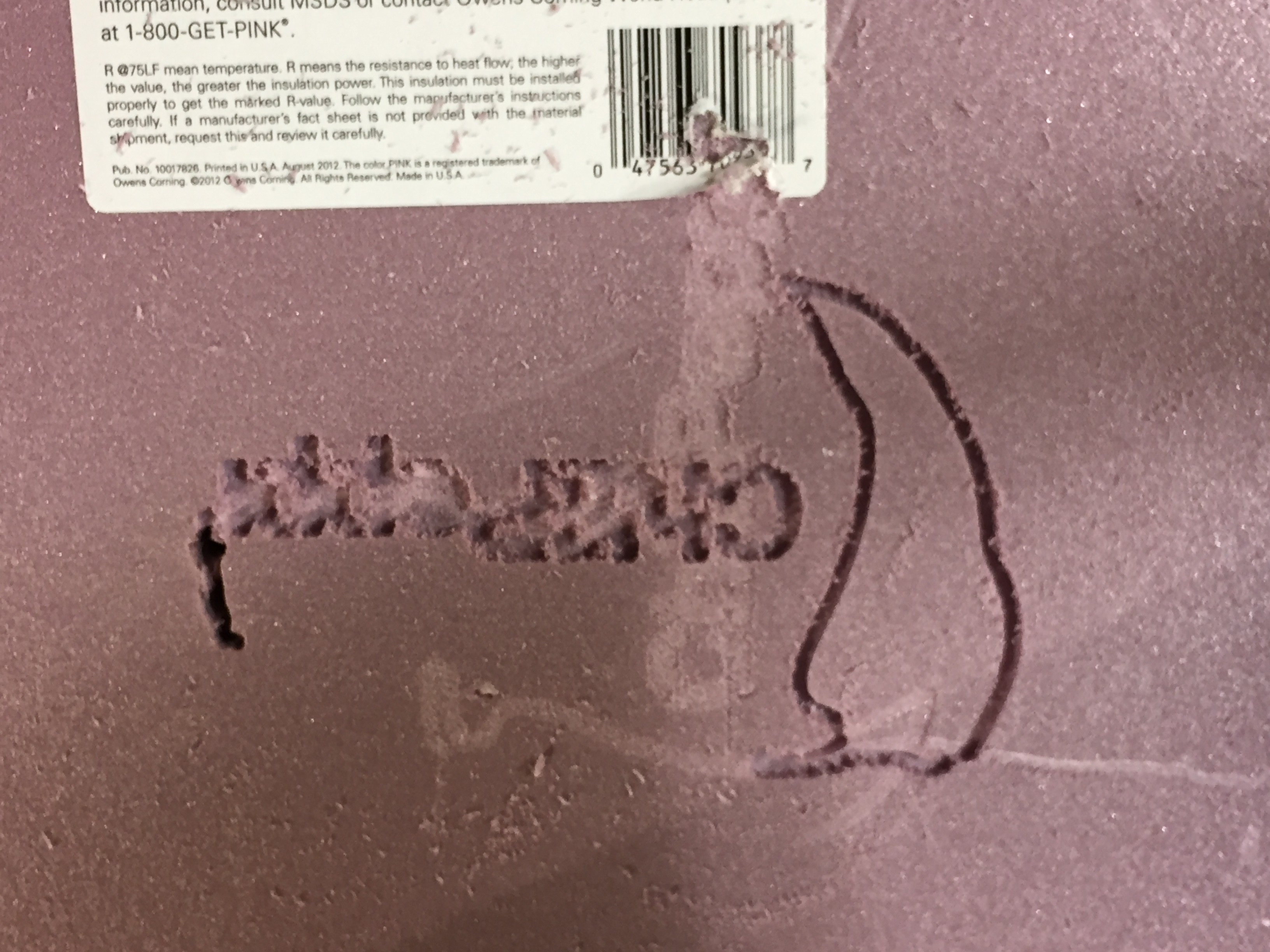

Styrofoam was one of my first cuts on my router early last summer. I have more images of the Chilipeppr logo in pink than I care to remember.

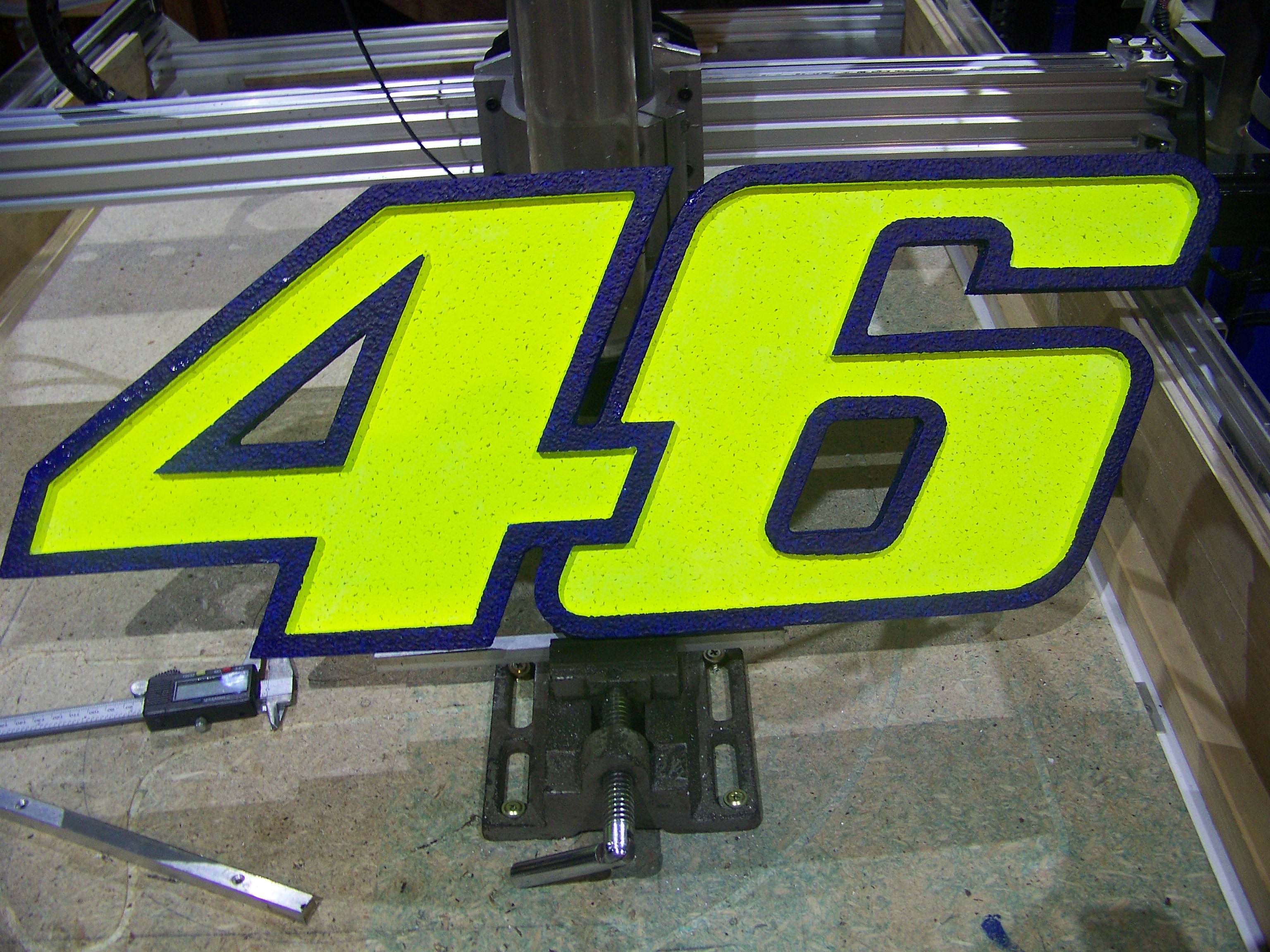

refridgerator box polystyrene packing sheet recovered from a local appliance store skip bin, acylic undercoated and kids poster paint
Super Nice … how did you paint the inside and outside of characters so precisely ? What software created the characters :)?
