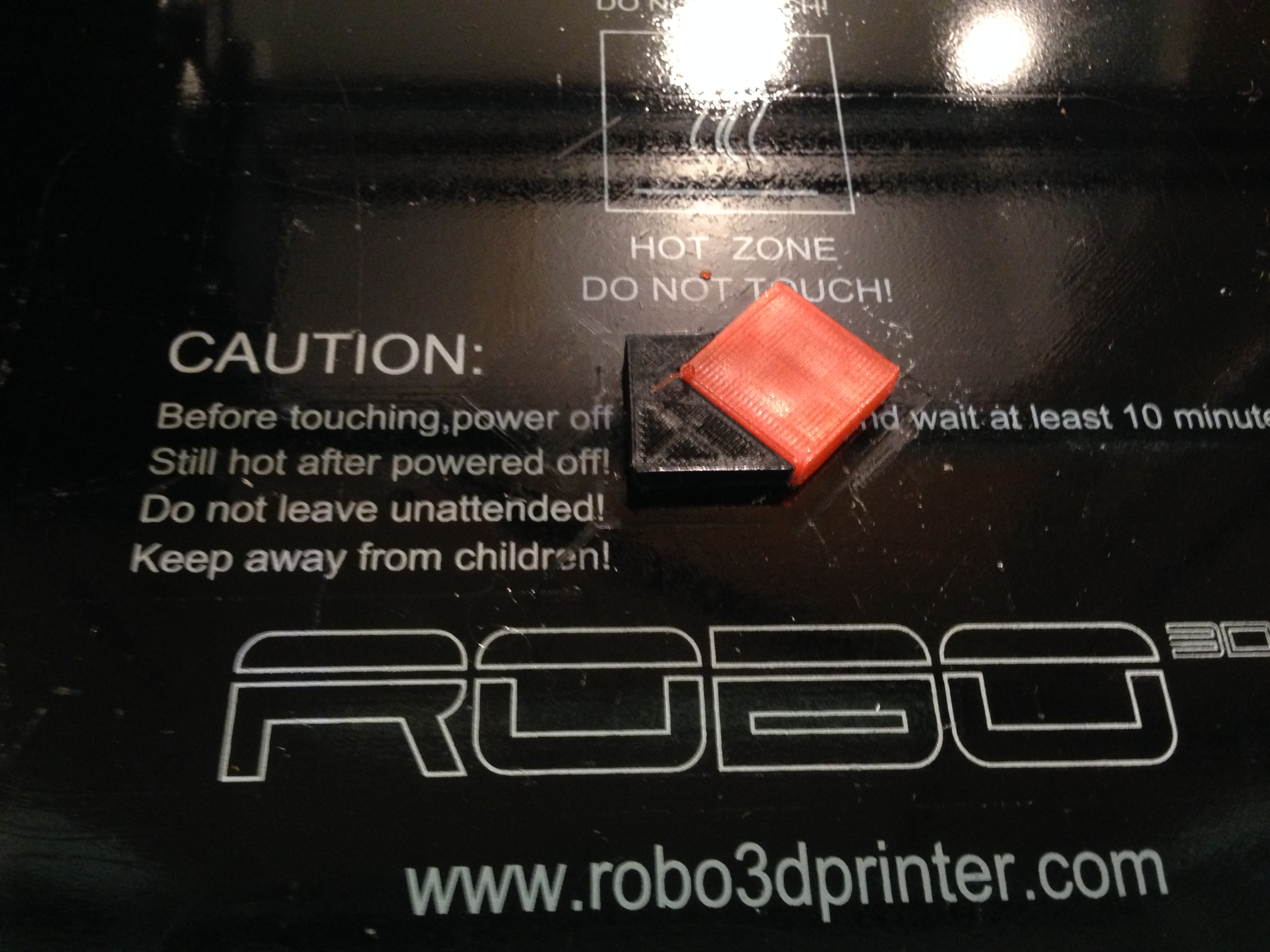

Finally got my dual e3d setup running.
Finally got my dual e3d setup running. Blew a driver, a polyfuse, and ruined 2 fan. But I finally got it.
Still some stringing issues to work out but it’s nice to see it complete a print.
Any tips?

As far as stringing issues, put up a skirt around your part very close to it. This’ll catch little blobbies and keep the outside edge clean.

We use Cura and it now has some awesome anti ooze features. We use both the prime tower and the ooze shield, pretty much eliminates ooze problems. It’s what we used here for the kraken http://e3d-online.com/index.php?route=extras/blog/getblog&blog_id=20
But it should apply just fine to a dual v5 setup too.
