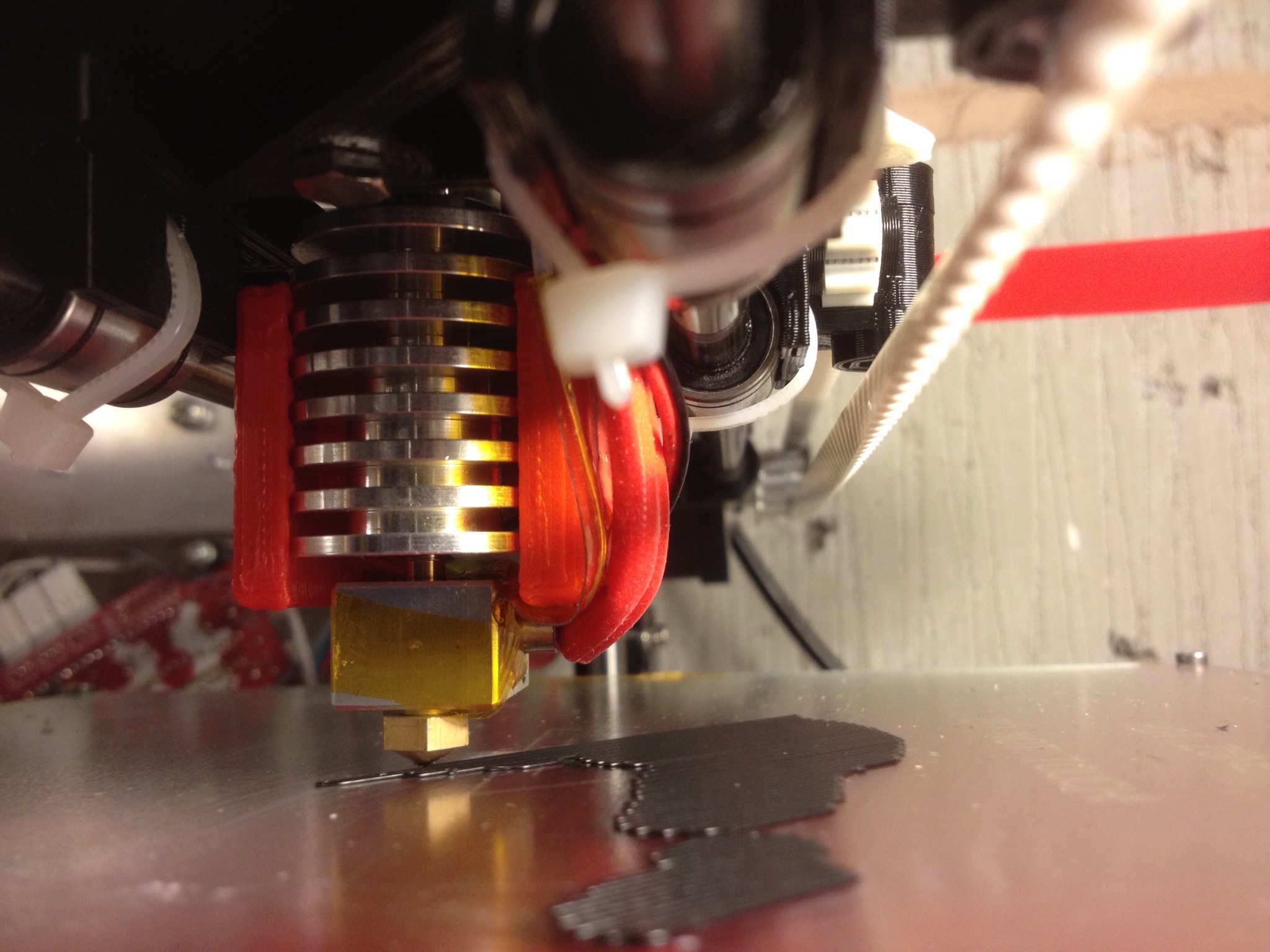

Finally got my new E3D-v4 hot end installed and working.
I had to lose the wing nuts and reverse and shorten the bolts holding the extruder to the X-axis because they collided with the new cooling fan.
I also had to remove my custom ducted part cooling fan (having only recently printed a new improved version) because the nozzle fan and fan mount wouldn’t fit inside it.
