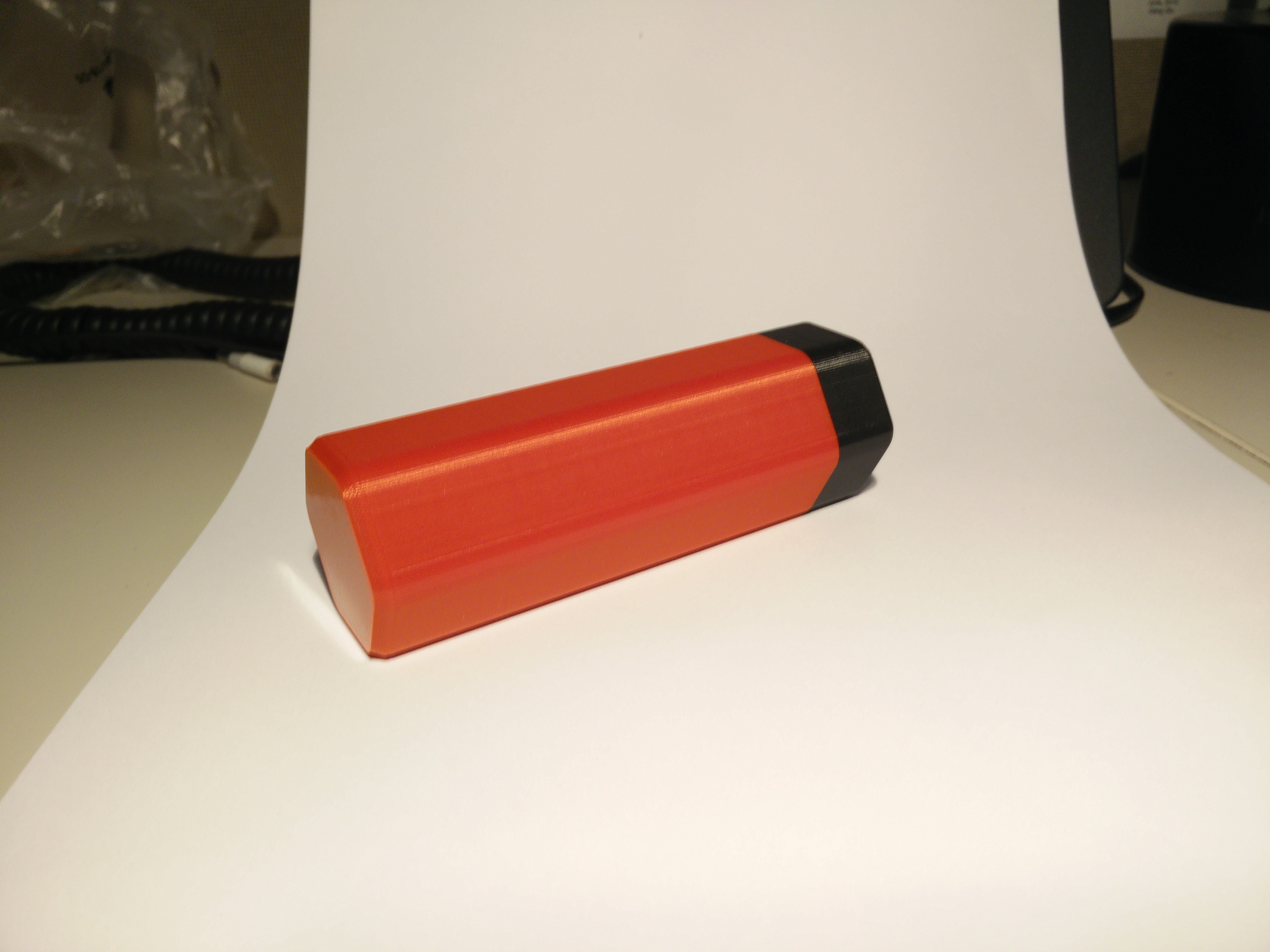

Finally got my printer configured for PLA. 65 mm/s, 0.100 layer hight. 3.4 mm retraction with 4 mm wipe. ABS is still a huge pain in the rear for me. But I will get there. Also planning to enclose Eustathios V2 completely which should help with ABS printing
Looking good. I might try the wipe myself, not had much luck with it thus far.
