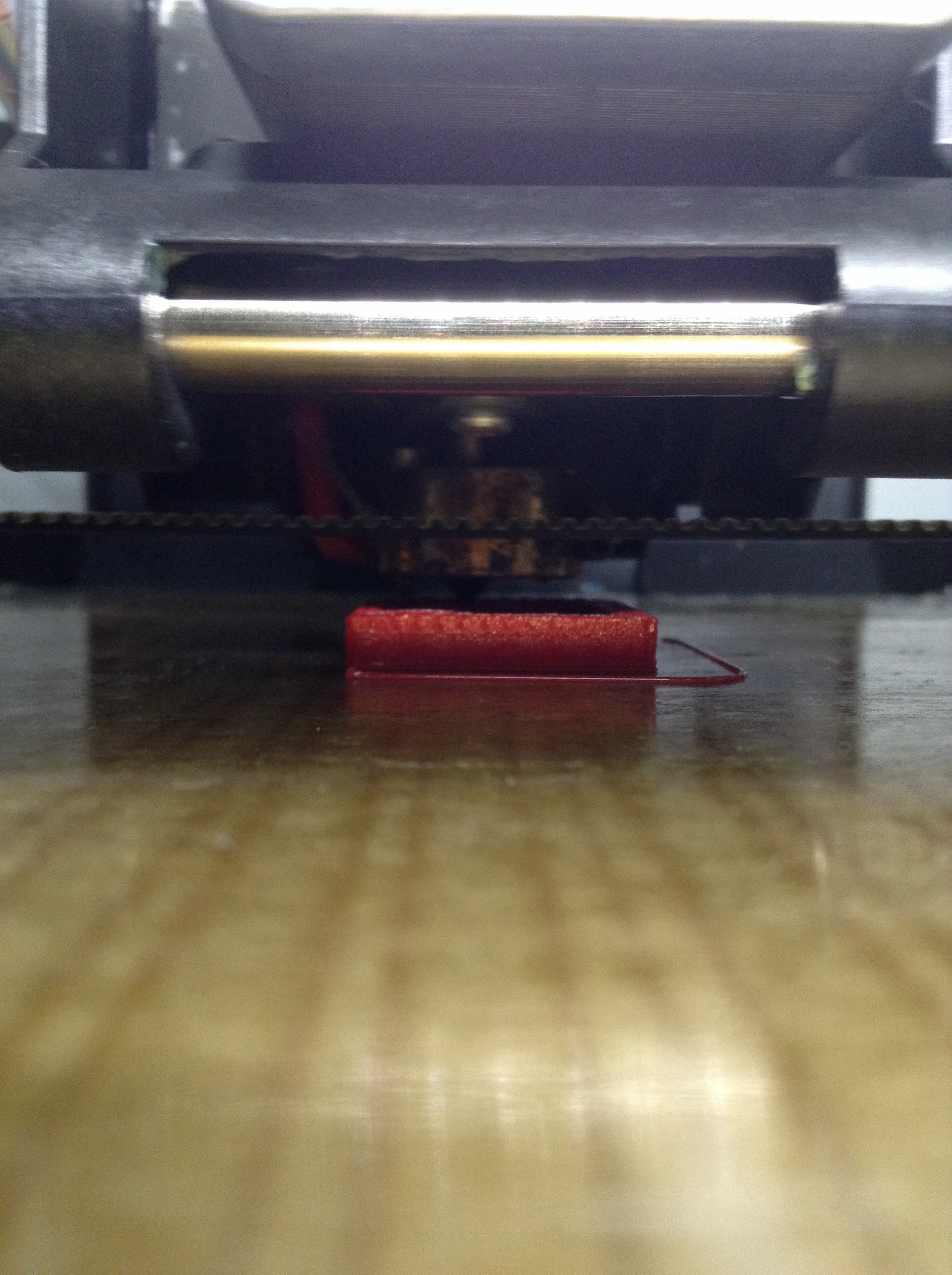

Finally got pet to work The layer quality is the best I've seen from
Finally got pet to work The layer quality is the best I’ve seen from my printer Hard to tell from the pic but the layers are barely visible
What filament is used here?
@Michael_Stockdale this is pet+ filament. I have used slic3r to set temps and then converted the gcode to .3w. I have an empty cartridge in the printer and i also have a resetter to make it think the cartridge is full
