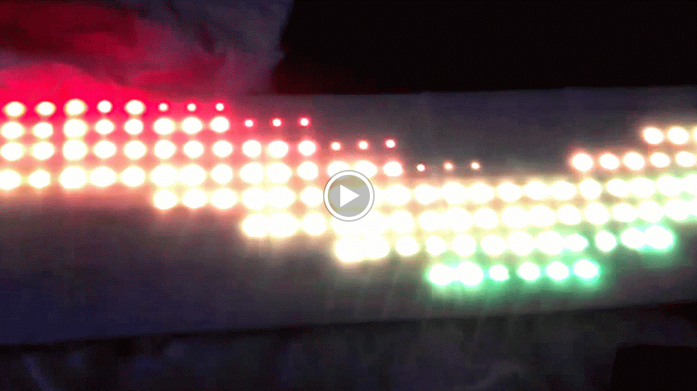

Finally got some matrix coding to work on my LED array! Too much fun!
Does that use strips? Very very nice by the way
https://drive.google.com/file/d/0B1X_0uptmQBiYlNoeXlXQTdVaVk/edit?usp=sharing
Yeah, I have been asking some questions on here latlely, the community has been very helpful in educating/shoving me in the right direction.
Wow so those are 3 addressing not individual correct? What chips are they if you don’t mind me asking
They are UCS1903 12v strips. I think someone recently mentioned most/all 12v strips control 3 led’s? I might be horribly wrong on that spec. In the video they are operating at 50% brightness, when I power them at 100% they are friggin bright! The array is 9 x 10 for a total of 90 ic’s.
