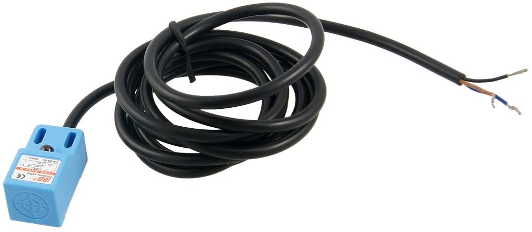

Interesting. I ordered a similar one (PS-05N) that should arrive tomorrow. I have an aluminum bed, but I use glass on top of it. It takes longer to heat up, but broken window glass is easy/cheap to replace. So you just hook it directly to the Printrboard’s Z-stop?

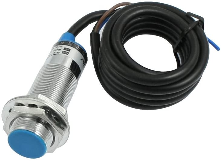

Semi-related: I bought a different sensor last year but it was much heavier than I expected. Just this weekend I got the idea of connecting it to a spare Arduino UNO, get readings from it, manually adjust the bed, and then remove the whole setup (no added moving mass). It seems to stay set pretty well, so it might be ok, but after seeing this post I may skip all that and just use the new lighter weight one like you’ve done.
This is the one I bought last May:
This is the one I ordered a few days ago that should arrive tomorrow (similar to yours):
http://www.amazon.com/gp/product/B00FZUECJA/ref=oh_aui_detailpage_o00_s00?ie=UTF8&psc=1

This is the sensor I bought. The rated DCV is 4.8-30 and you want it just around 5V. You may have to step the voltage down on yours but it might work at 6V but don’t take my word for it. Once you set the firmware, it’s ready to go. Although, you will have to familiarize yourself with the auto level gcode command and editing your start gcode. I ran into a problem where the z offset would not save using the m212 command. Had to write the z offset in my start gcode
@Chris_Lau I must’ve been tired when ordering…twice. This may explain the resolution problems I’ve been having with the first sensor. The analog read kept showing values of about 140-190. I had been considering attempting to amplify the sensor output range with a cheap transistor (2N3904/2N3906). But now, looking at the input voltage range, I think the voltage being too low is the cause–just not enough power to drive it properly. So, I probably just bought the wrong damn thing. Hmmm…I wonder if I could just power it from the 12V rail and still read it from the Arduino’s analog read pin…without frying the Arduino?
@SirGeekALot : See @Thomas_Sanladerer video about auto-tramming (linked above) - you should use a level shifter (may be done with two resistors or other HW) to drop the voltage from 12v to 5v signal. Also, I would recommend ditching the metal threaded ‘case’ (cut/file it off!) to reduce weight - you don’t want that much weight hanging on your print head… I sill haven’t decided on which sensor to buy…
