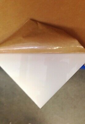

Finally got the speaker put back together so I could take some pictures of the cast acrylic sheet from Ebay being used as a diffuser. The first video is of it with the LEDs moved back about 1/4" from the back of the sheet.
And here is a video showing how it looks when the LED matrix is pushed right up against the back of the sheet.
I’ll put a few more – the diffuser makes the plain old FastLED rainbow look really cool, IMO. https://photos.app.goo.gl/3KhUpzDYygKvdtO42
And one more with the LEDs pushed close against the acrylic…I have a knob on the speaker that moves the LED panel closer/further from the diffuser, so you can change the look
. https://photos.app.goo.gl/v5YPWE1TFI8i6zIe2
and lastly, the link to the diffuser again:
