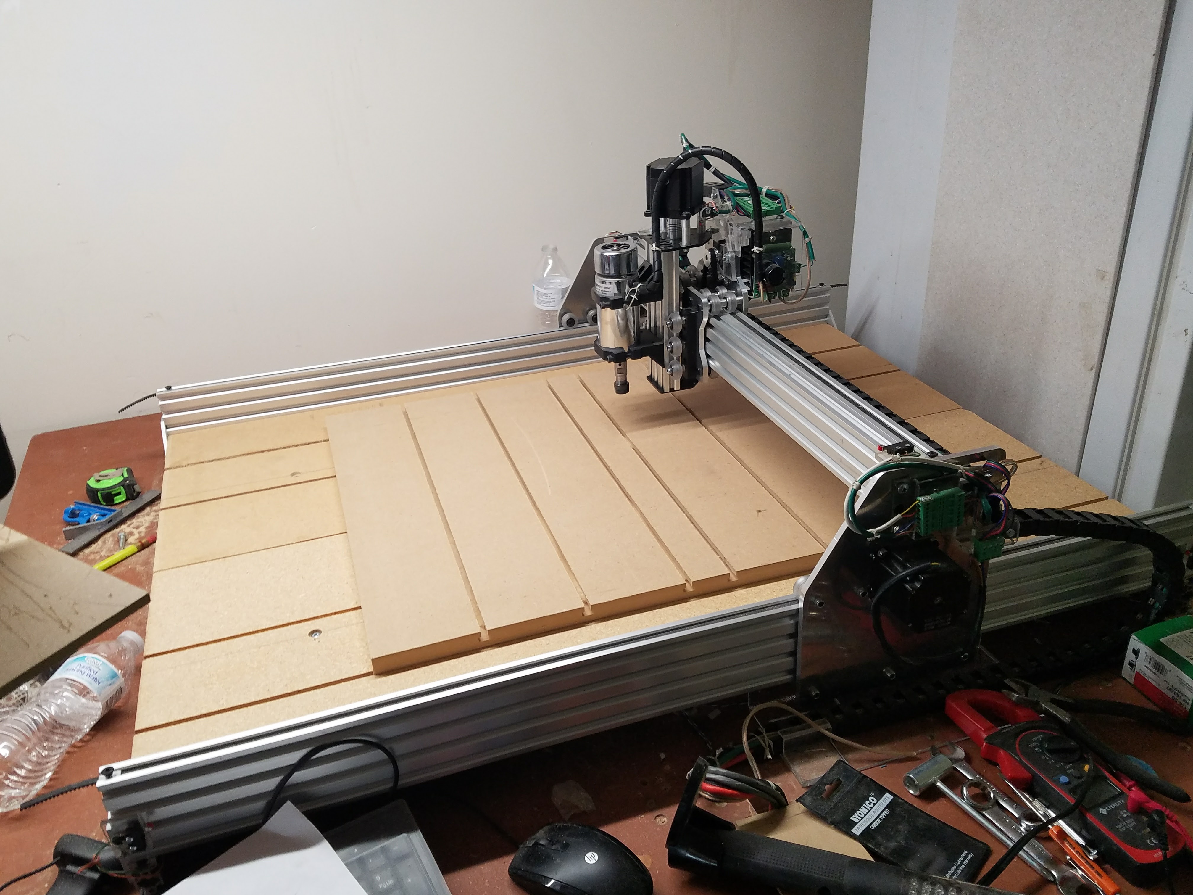

@cprezzi ​ - if you already have a CNC, is there a reason you would not want to add a laser diode cutting module to it? It seems that extra rigidity and stronger than necessary motors would not be a negative?
The big reason that I would not run a laser on a mill is that it is difficult to make it safe. Enclosing and interlocking a set of covers on a mill is problematic.
I don’t see any reason why the rigidity of this mill is not a plus for a laser? This OX unit is belt driven.
I am running TinyG and Chilipepper on this unit (only because that is what is popular on these setups) and will later consider if I switch to LW + Smoothie.
I am still struggling to get to one tool chain, one controller and firmware and one software interface for both this OX and my K40.
I doubt its in the cards …:(.
Many people do add a laser diode to their large format CNC. I’m was thinking about it but decided not to due to safety. With only one set of eyes, I don’t want to take the remote chance that a reflected beam can damage them. I don’t have very good eyesight to begin with.
