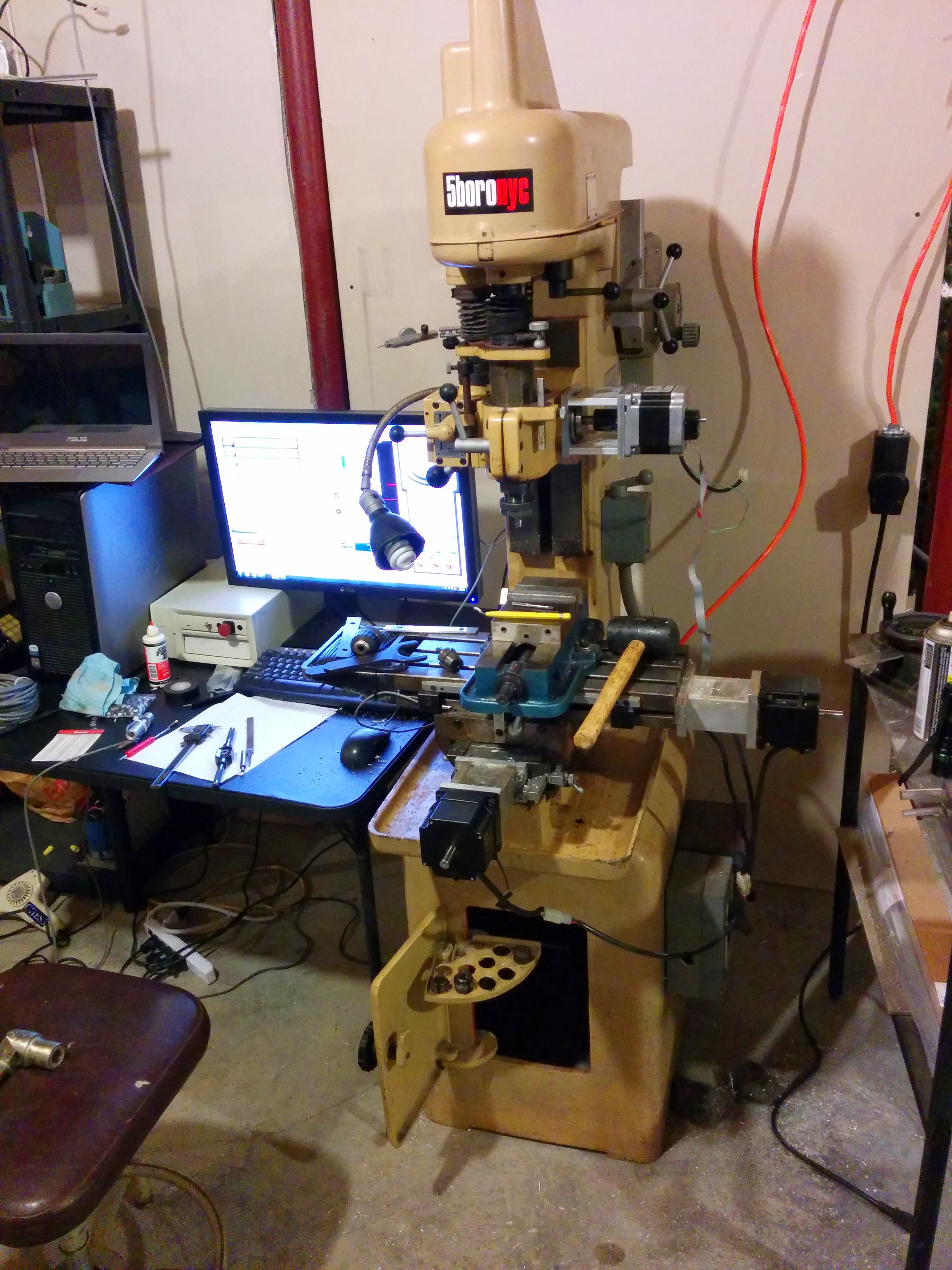

Finally got the Z axis done on my mini mill. Well the parts anyhow.
Finally got the Z axis done on my mini mill. Well the parts anyhow. I need to wire up the driver and the motor now.
Nice… Little close to the PC there it seems…
It’s a bit “cozy” but it work for now, until I get my mpg pendent wired in.

It is an OK little machine. Have the lead screws been changed to ball screws?
I swapped out the acme lead screws for ball screws on the x and y. The Z only has .001 backlash. The X and Y balls screws are the non preloaded type so they have .0015 to .003. I have some used screws that are preloaded and have zero back lash. Maybe some day I will switch them out, but it will mean some new adaptors be made and fitted.
Nice Jig bore who makes that one?
It is a Downham made in England.
