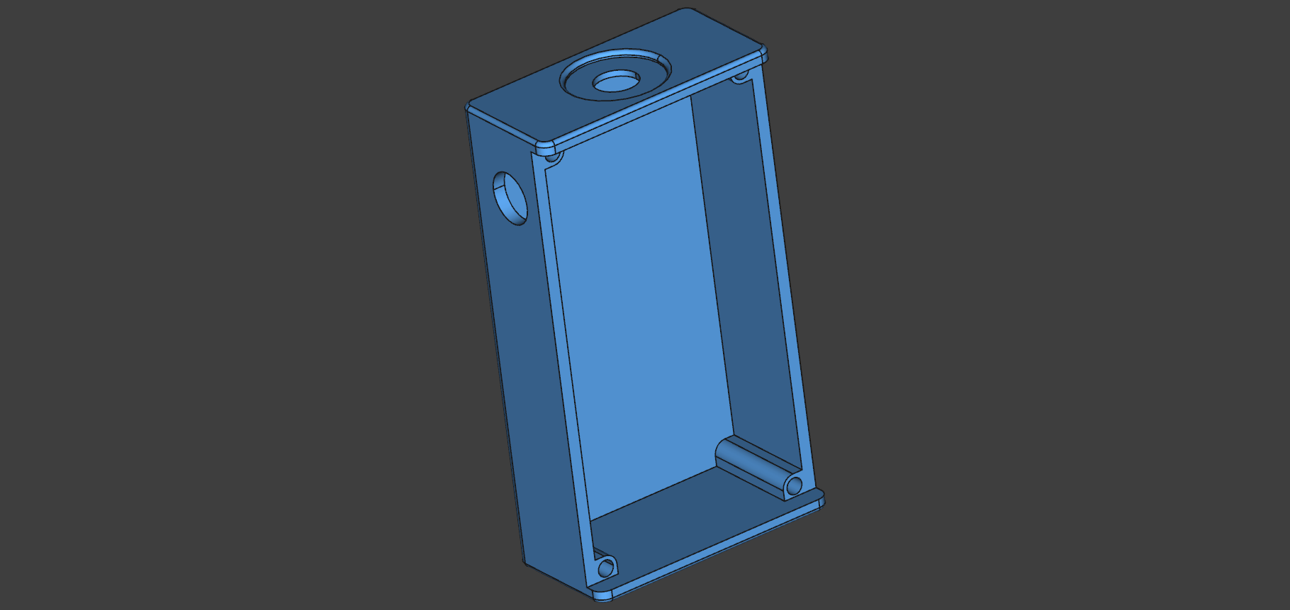

Finally got to grips with Sketch based design in FreeCAD.
Finally got to grips with Sketch based design in FreeCAD. I’ve always just hacked pieces out of primaries with Boolean differences. I’ve been sat with tutorial series over the past week or so (stuck on the Kodi RasPi I have) whilst lounging about. I’m finally able to go back and make tweaks quickly rather than having to delete and start again. Part of my Business is Vape Box Mods, so I’ve come up with this design as a exercise. There are 2 versions, with the 2nd just having the measurements changed. I class this as a win.

@Tom_Keidar - it is, I’ve not been really following along more watching them to get an understanding an working from there. There are a lot of Sketch based CAD programs out there, so it’s pretty much transferable, once you get your head around the new program. So in that way, it’s damn worth it. I’m starting to prefer it as I can go back and tweak measurements etc, I’m still getting my head around it.
