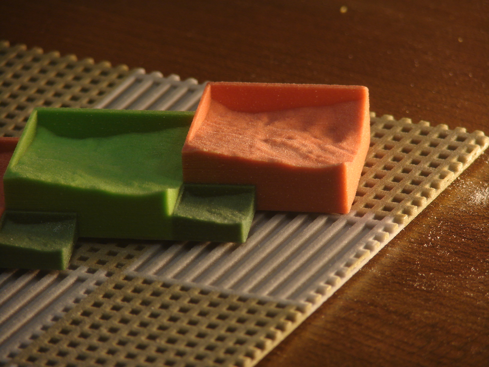

Finally had time to color and print the contour tiles
I’m not exactly sure what I’m looking at here. Could you give a bit more information?
This is a test print we tried after using a webcam .wmv file converted to a ply mesh…then turned to an stl file for 3d print
So frames from the video were turned into a heightmap, then 3d printed? Interesting!
Yes, but I had help from a software processor, vi3dim, and the video must have a regular rotation speed. This was the data from a video rotation of a sketch on a peice of paper, no real z dimension, but the stl conversion ends up with texture regardless
The cube shape and boxes were added in sketch up later
