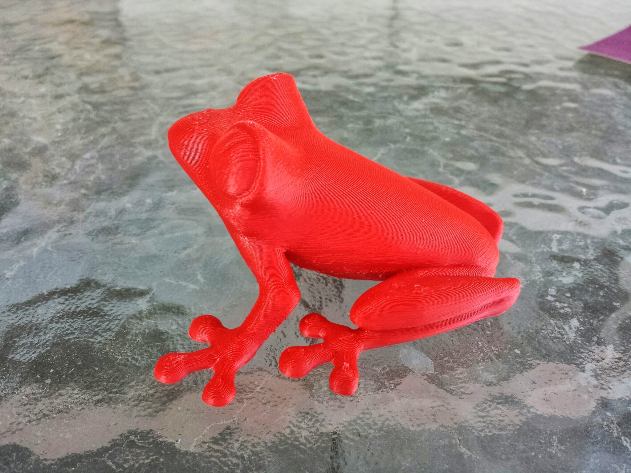

Printed the 45mm tree frog scaled up for fun with a little post process sand/file with an acetone smoothing at the end. Then printed a huge spiral vase from thingiverse for kicks. The vase is pretty cool, covered in car mfg logos.
