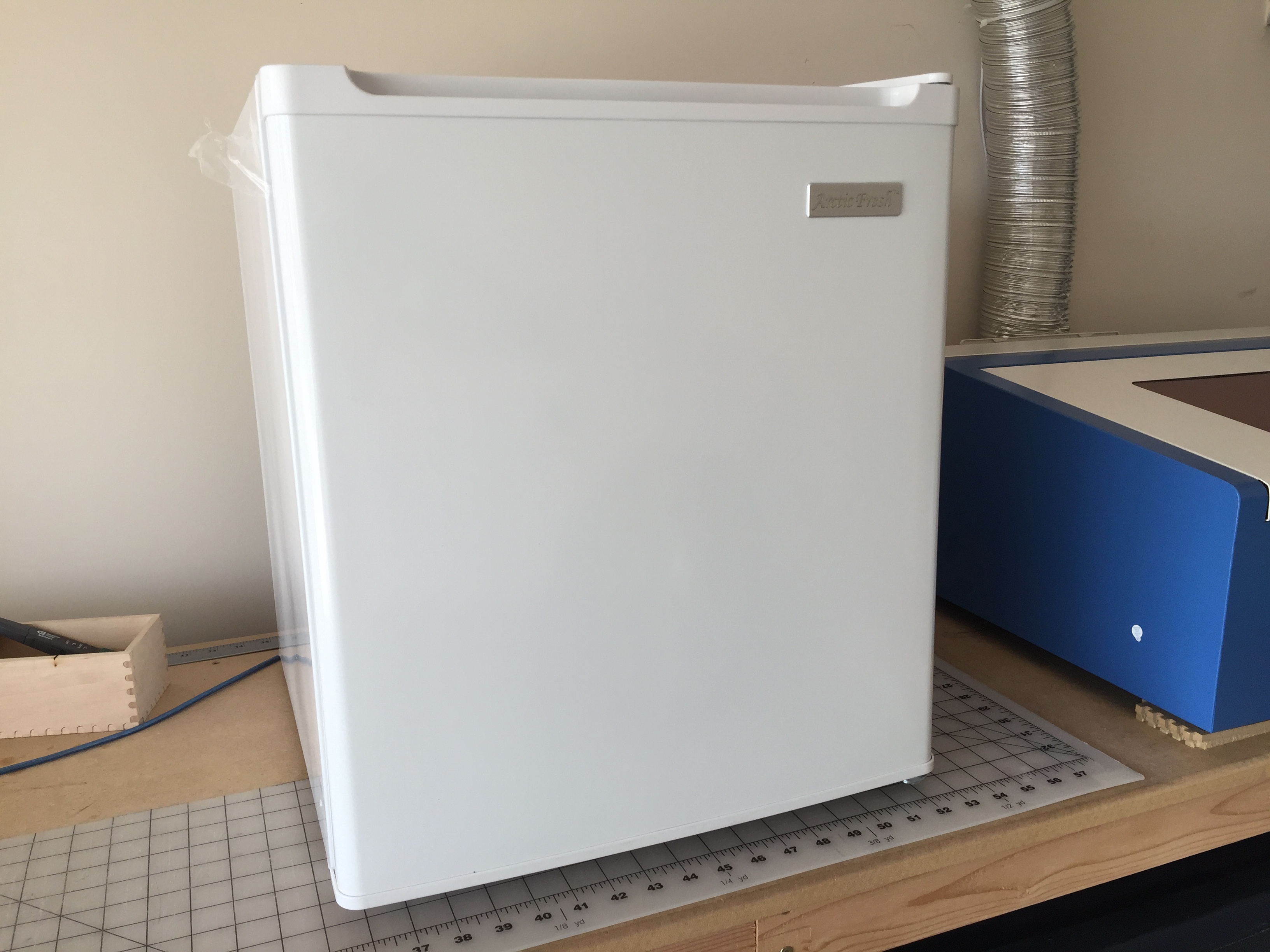

Finally I decided to work on a proper cooling system.
Brought home a mini refrigerator from Lowes for $69.
Not sure if I’m disassembling and dropping the cooling element/temp sensor inside the water bucket or if punching a couple of holes and putting a water reservoir inside the chamber. Probably going with second option.

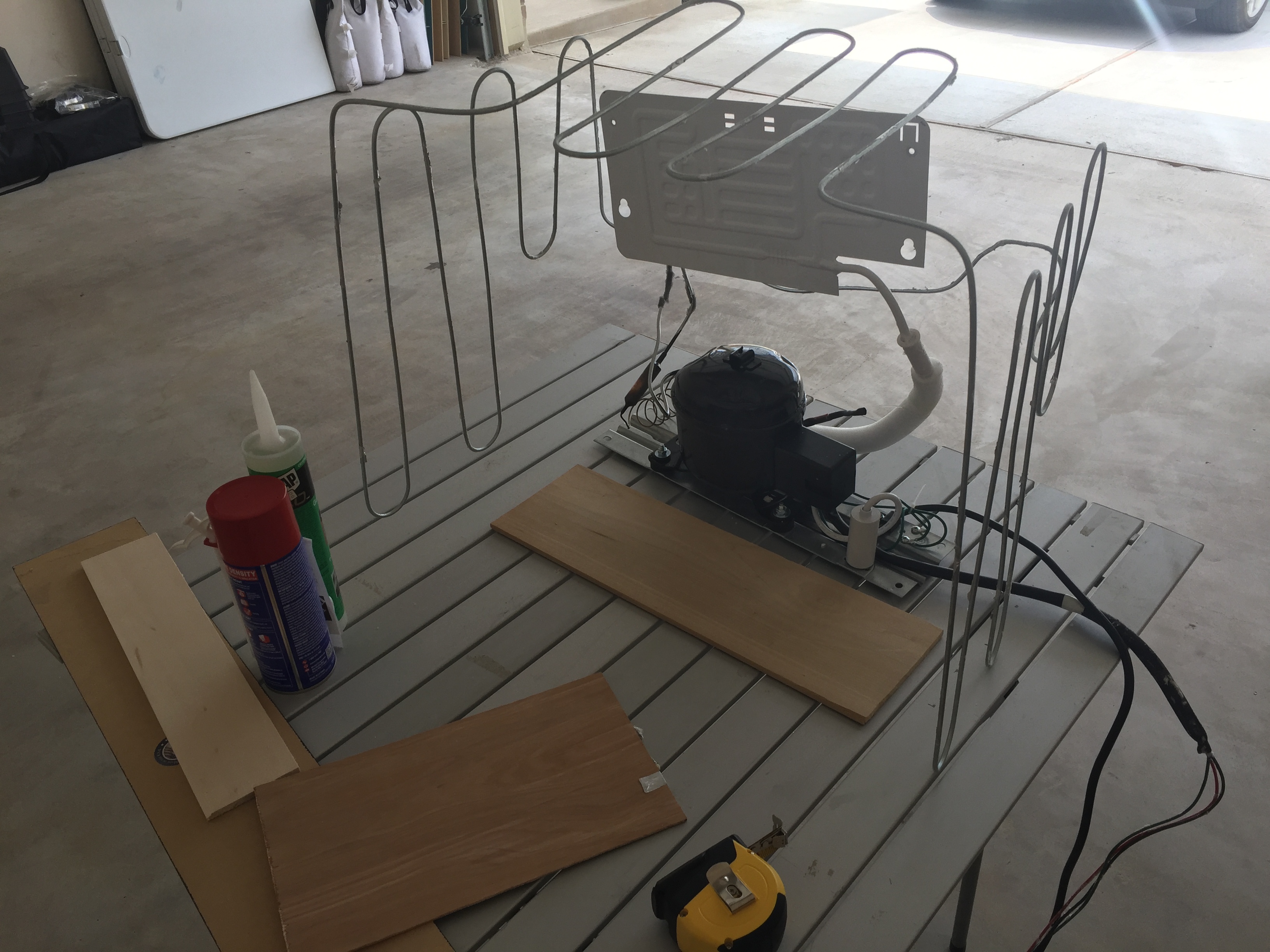

WIP
I think adding a reservoir in the fridge with a cool in the reservoir should work well
Any plan to swap out the pipes and heat exchanger?
Could go pretty small with that setup, i used a similar sized compressor to cool a PC years ago :slight_smile:

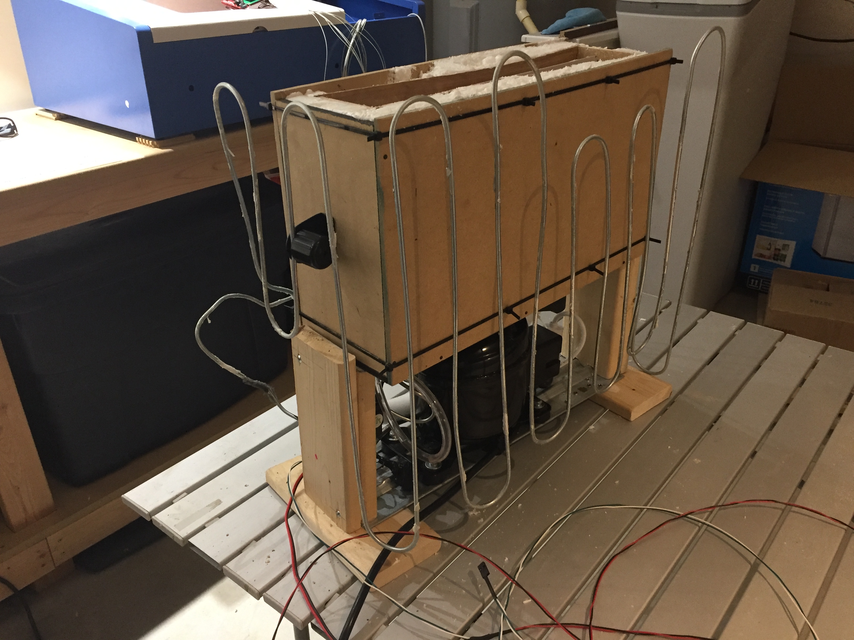

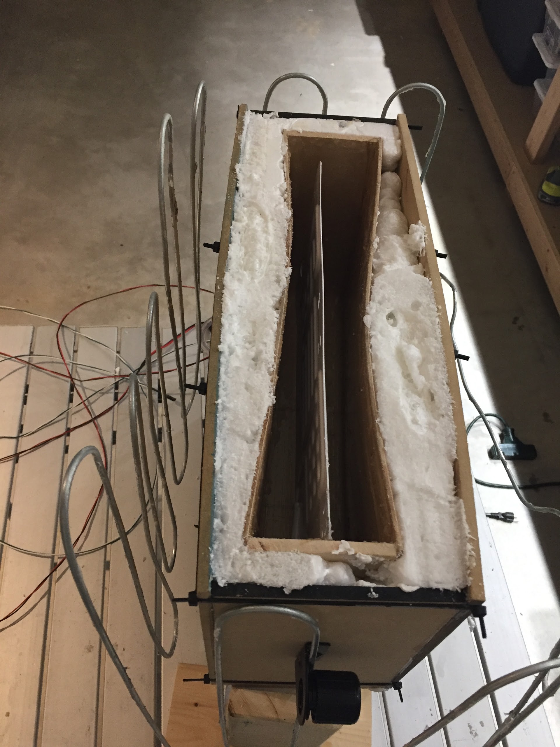

Building a mini chamber (1/4 gallon only)
Actually less than a quarter (first time using foam - that thing grow as hell)
Still working on the condenser coils. Lid in the works.
I’m confused… are those the hot coils…
@Josh_Rhodes Yes
