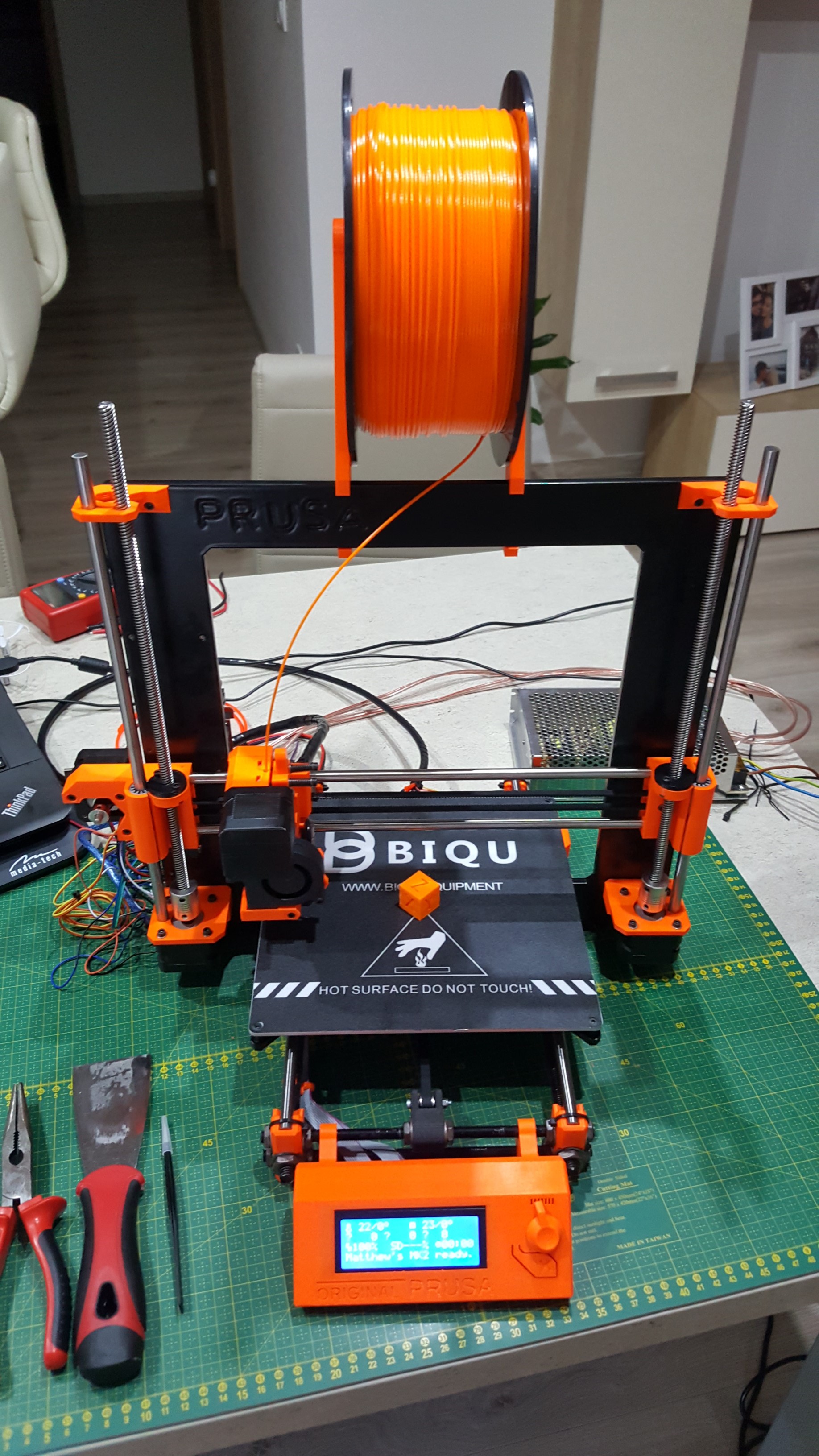

Finally I got my first 3D printer working.
Finally I got my first 3D printer working. It’s based on Prusa MKII with original E3D v6 hotend and a lot of chinese parts. Big thanks to @Thomas_Sanladerer for great youtube tutorial.
I need help with some tweaks. Overall I’m satisfied with print quality, just small detail next to window of 3D benchy is weird (don’t know how to call such a thing). Basically imperfection started with bottom edge of window and after few layer it disappeared. (see pictures below). Do anyone have any advice what to change in slic3r settings to make it perfect? Or is it a hardware issue?
Could be he weakest part of a Prusa; the extruder skipping.
Looks like too much heat, and not enough cooling
