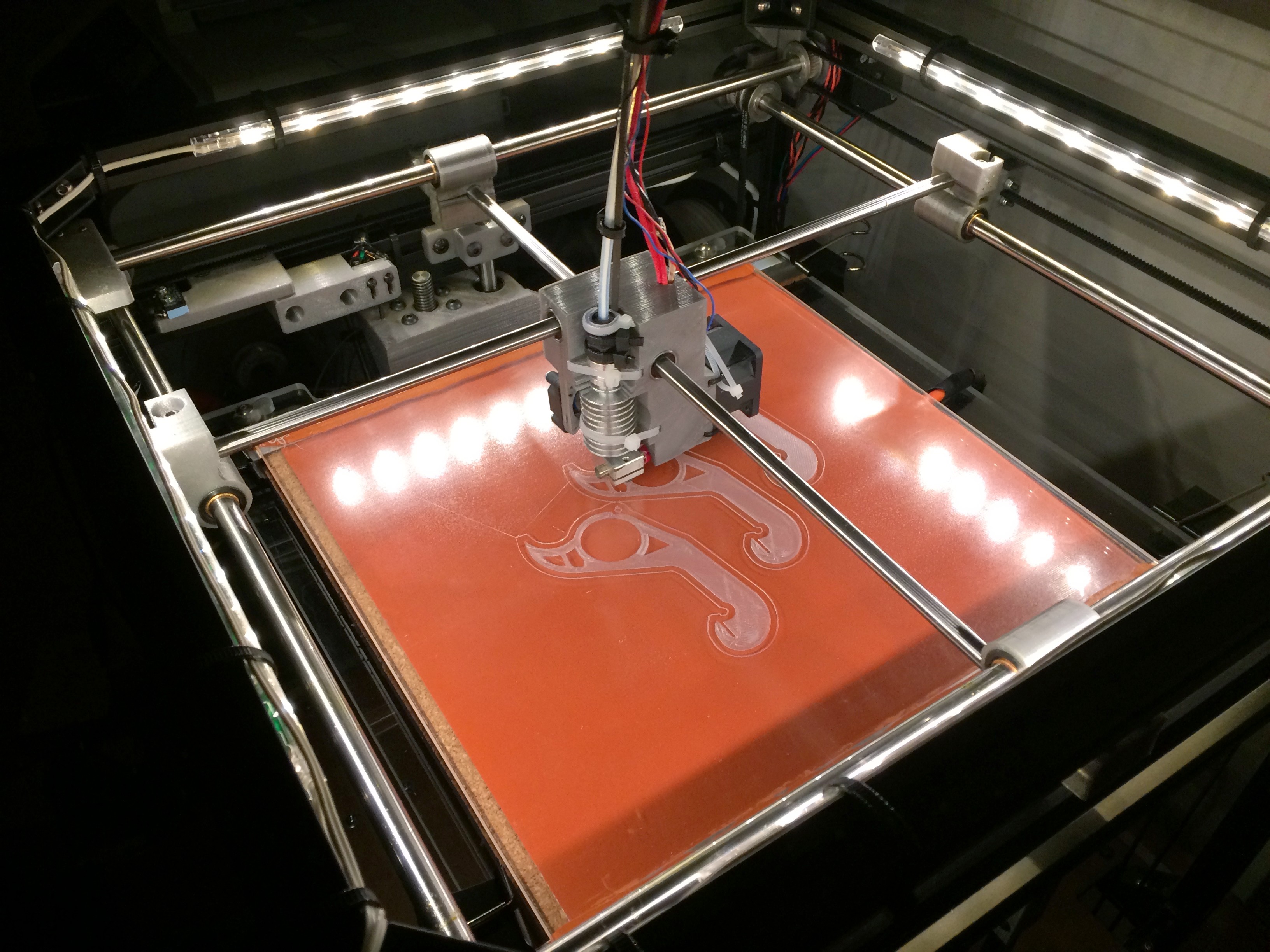

Finally “installed” some LEDs on the #Eustathios. By “installed”, I mean I zip-tied some Ikea dioders on…but hey, at least I don’t have to leave the light on in the room to check the prints via webcam now. Printing some bottle-openers for a few friends, since that’s what 3D-printers are made for.
Yeah, I need light because my night vision is going to hell and an unlit build plate might as well be pitch black.

I printed little housings that the LEDs slide into from the end and bolted to the frame.
Looks great. I agree it helps with those webcam print checks late at night.
