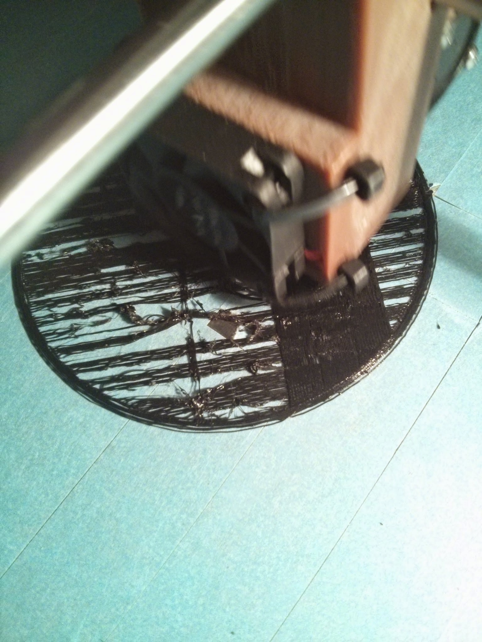

Finally it’s (no name yet) printing. Small objects work well. But when is speed up or print lager objects, the filament starts slipping back while printing.
I tried different things to get a constant filament flow.
max Power on Extruder Motor
cooling extruder motor
reduceing flow
higher nozzel temperature
check filament diameter
reduce print speed (normally 50mm/s (80mm/s infill, 40mm/s outer lines))
But nothing helped. The filament still slips back. It’s not the torque of filament drive. the whole motor gets turned back.
I’m useing a “airstripper” extruder and an cheap china e3d v5 remake.
Any suggestions what i need to change?
in the first picture you can see, what happens because of the slip back. The rest of the pics show my first print - a model of the comet which is observed by rosetta orbiter. The dimension test shows nearly perfect dimensions.

@Ubaldo_Sanchez Nozzle temp is ok. i checked all before first print.
@Alex_Lee I think it’s not underextrusion. It seems like to much filament is pushed into extruder and so it slips back. Fans are running. When you say ‘mount’ do you mean print head? Its made from HIPS. Lower temperatures dont make it better.
@Erik_Scott Bed level is ok. The problem exists the whole time. Not only first layers. i also tried up to 203°C. Dont make it really better.
