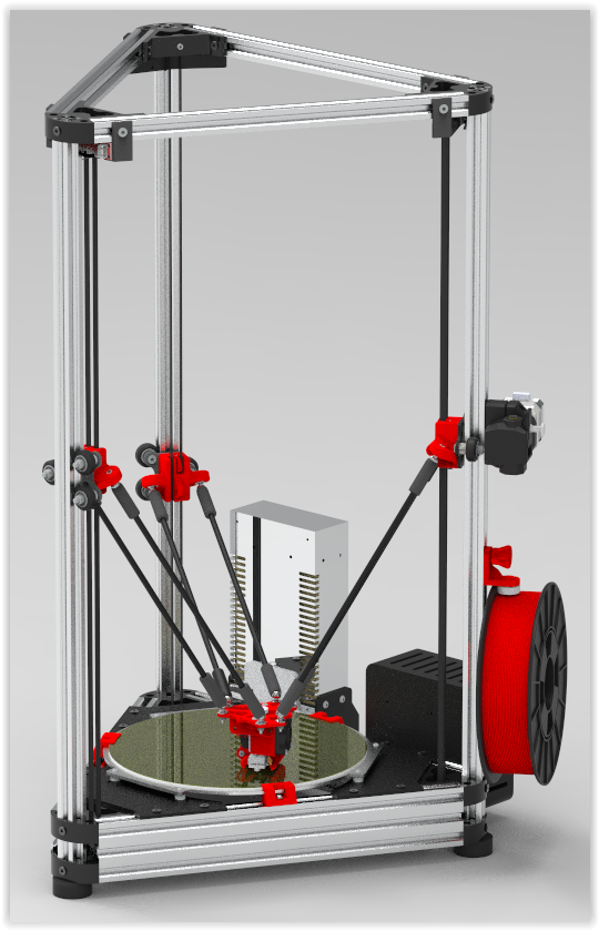

Finally made a full 3D Model of the Talos3D Tria Delta. When @Alex_Lee and I built ours back a few years ago we only made models for the required parts. But now the full model is put together (At least for the version I built). And it has been uploaded to the github.
There’s no bungee cord in the renderings…
@raykholo yeah, and the Bowden tube is missing too. I tried adding them, but then I can’t move the carriages around in the solidworks model without creating weird mating failures in the model. So I left them out.

Do you have some details about the rods size, balls and stuff?
I’m using a Cherry Pi 3S, I think I would only need the carriage, rods and effector !
Thanks !
Balls and rods are all off the shelf items from ultibots. Mine are 288mm, but they have them in other sizes. They also have printed end cups, or machined delrin.
https://www.ultibots.com/magball-arms-288mm-printed/
I’m at 240mm but it’s a little short, 288 might do… I’ll look with them, thanks !
