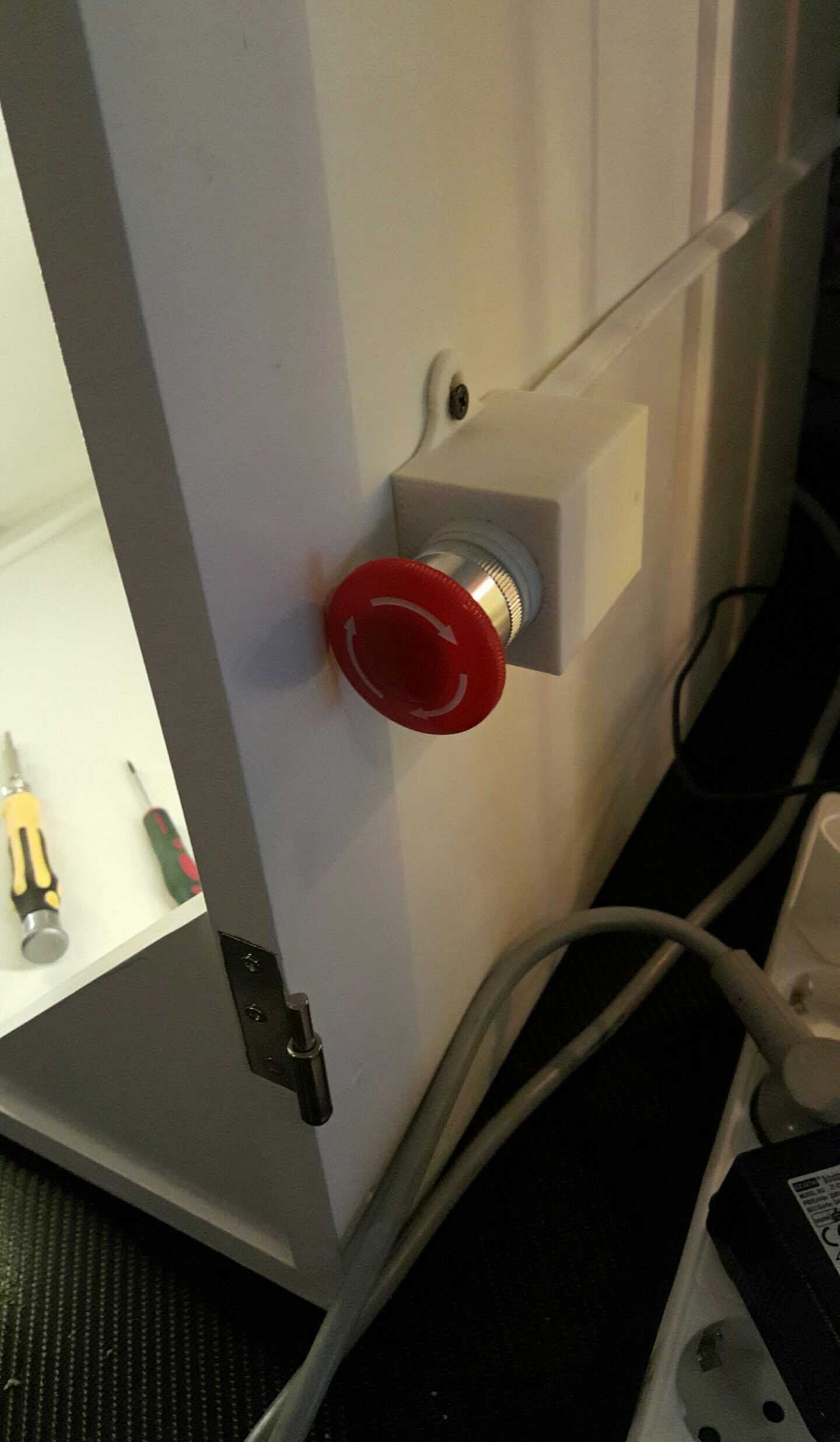

Finally! My new printer now has a E stop button.
Finally! My new printer now has a E stop button. Something i newer got around fixing on my old mendel90.
Btw my mendel90 looks so small now…
Good plan. I’d like to keep mine more exposed, so I can slap it easily.
How does your button interface with the printer? Direct power cut, or something in firmware?
How did you get it to send the command? That’s the one thing that’s keeping me from doing this
I hooked mine to the reset pin.
I have a relay between psu and ramps board. I control this relay with the M80/M81 command. The e stop interrupts the signal to the relay
