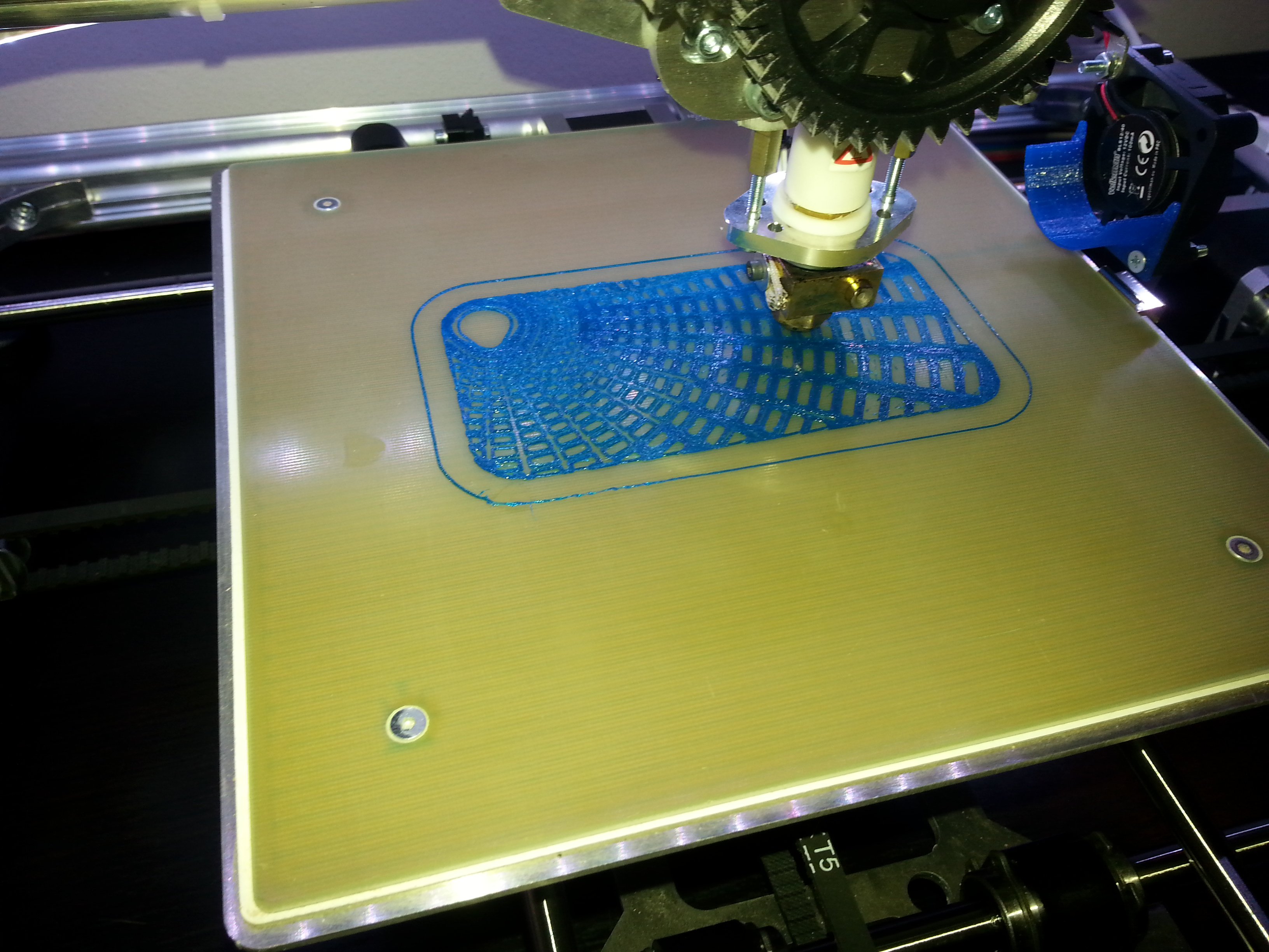

Finally objects stay well attached to the plate just passing some fine sandpaper on
Finally objects stay well attached to the plate just passing some fine sandpaper on it.
What is the build plate made of?
Vetronite … I’m not sure how is called in English
Fiberglass
With this model now also starting from January and I also had problems with the fact that it’s poorly attached. After sanding, it was better but not perfect. With ABS, it was practically unusable. In addition, the board was in the middle of about 0.2 mm higher. After searching for better options, I chose the mirror 3 mm (metal bottom) and am applying glue to the surface. I bought it from a vendor filaments, but apparently it’s just ABS dissolved in acetone. The results are significantly better. Place glue is also used kapton adhesive tape, but I have not tried it yet.
In the middle line of the x axe also my plate is slightly higher but in terms of attachment after passing sandpaper the objects in PLA are now very well stuck to the plate and hard to remove after printing and I’m quite satisfied about how the pieces are coming…
