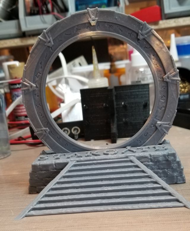

This was my first long print. The base took over 4 hours. The filament took a bit to dial in. It is Melca brand which I purchased about a year ago. I do not see it much anymore. It takes more heat for a consistent print. I am running 220 C without any stringing. I have also upped the bed heater to 70 C without any sagging. It is some tough stuff! The bottom shows why I only print on glass. I hand leveled the bed so I see where I need a slight adjustment.
stargate bottom
Nice stargate. :cyclone:
