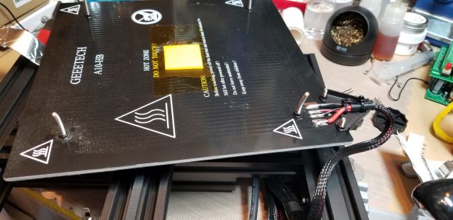

Well I finally got around to getting the new printer put together and running. It was packaged very well but the Heat Bed level nuts had come loose and the bent the screws.
hb
A quick trip to the hardware store took care of the problem. As everyone complains, instructions are terrible but I was able to figure it out. There is an awful lot of spare screws. Not really sure why. The bed has a custom layer that was destroyed after the first print would not release! It is removable so off it came and I will replace it with a piece of glass. I like the way glass gives the first layer a nice flat smooth finish.

For these type of printers, I like the upgraded springs that you can get pretty cheap online from most of the usual places. Having a little stiffer spring rate seems to make the leveling reliability higher. You don’t want to go too stiff of course or it can artificially put a bow into the bed if one of the screws is set imbalanced from the rest. I also add a phenolic washer on the top of the spring for these PCB heated beds so that way the metal spring will never potentially be in contact with one of the heated bed traces on the underside.
