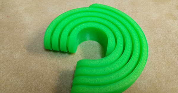

Printed the @Whosa_whatsis ​ Arc Gimbal he just posted to: Arc Gimbal | Whosawhatsis | YouMagine
Great model, my kids were facinated by the motion.
I printed this myself last night in red esun petg. Almost perfect, the outer rings all popped loose with a bit of twisting but the innermost one the cone snapped. Still works but not as smooth as I’d like.
Any tips on how to tune for this kind of thing? Reduce extrusion multiplier? (already kinda low tbh)
@Ben_Delarre I just used my default PLA settings. But since there is a very low step-over angle created by the radius of the edge of the rings it will be prone to lifting at those edges. I used PEI on the bed so it sticks pretty well. Plus I added support at those edges to help hold them down (not sure that actually helped though). I think the big thing is make sure you run at a speed where cooling can keep up to limit curling and I think you will be set.
Hmm don’t think it was a bed curling issue, the inner rings cone stuck to the outer ring a little too well. You could be right on cooling though, and I know petg is sometimes a little hard to remove support from since it bonds to itself so well. Maybe not the best material for this type of print in place object.
