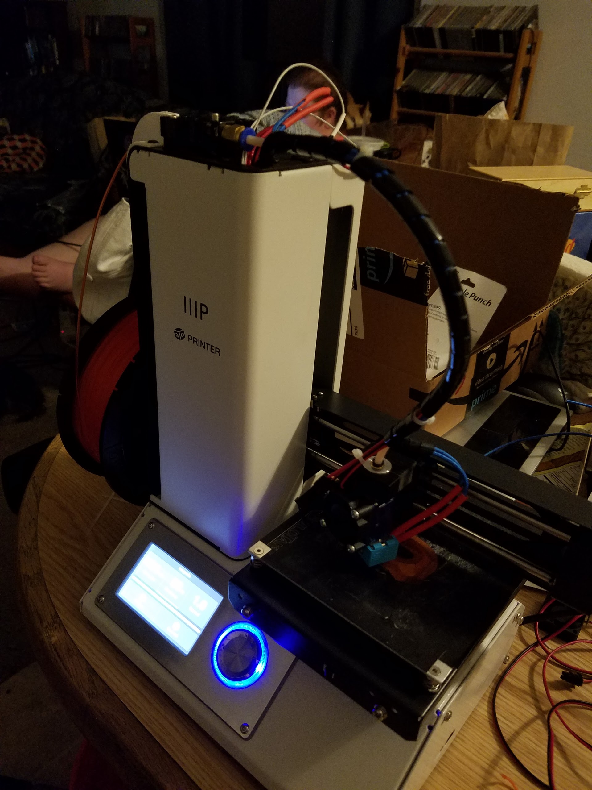

Finally replaced the stock hotend on my MP Select Mini with an E3D v6
Finally replaced the stock hotend on my MP Select Mini with an E3D v6 hotend. Wound up doing a bit of soldering for the thermistor and heater cartridge, and reused the stock fan. Currently printing a lucky cat using some spare clear tangerine PLA to test it out!
i dont think soldering the termistor is a good idea - the temperature around the heater is larger than the solder melting temperature. you are supposed to use the metal tubes provided with e3d.
@Cristian_Nicola I didn’t solder directly to the thermistor. It came with two short leads terminated in a quick disconnect connector, and the kit included cables with the matching connector type. I soldered these cables to the existing wiring. No solder was used anywhere near the hotend.
They still include ferrules to crimp connect (avoids soldering), but they’re a pain to use with stranded copper wire. And the style of thermistor they’re using currently doesn’t have traditional leads, so the ferrules seem kind of pointless now.
