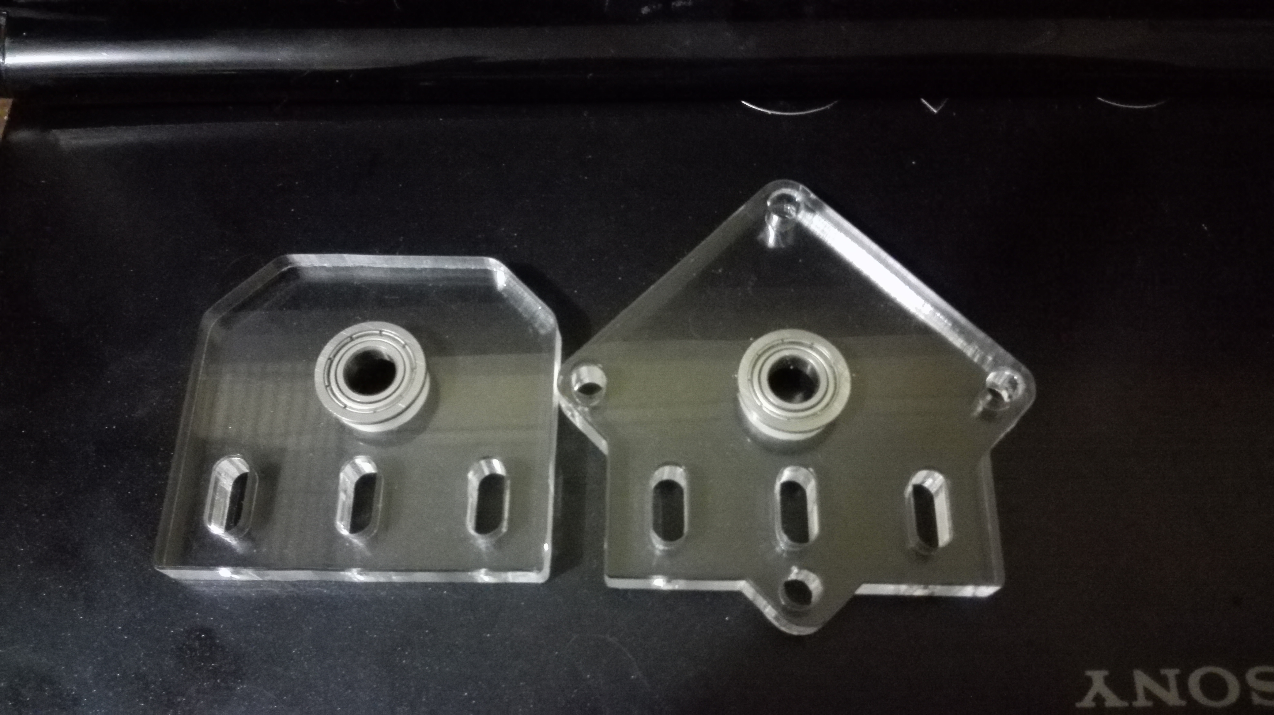

Finally the Z axis plates Ready
Flaged bearing mounted on 8mm acrylic plates
The files from all plates are here just change the falnged bearing bore from 16mm to 15.6mm. to press those tighter

The nice work… any flex seen on the gantry plates?
No flex seems at any plate
But remenber to chane the flanged bearing bore from 16mm to 15.6mm to press firmly them
