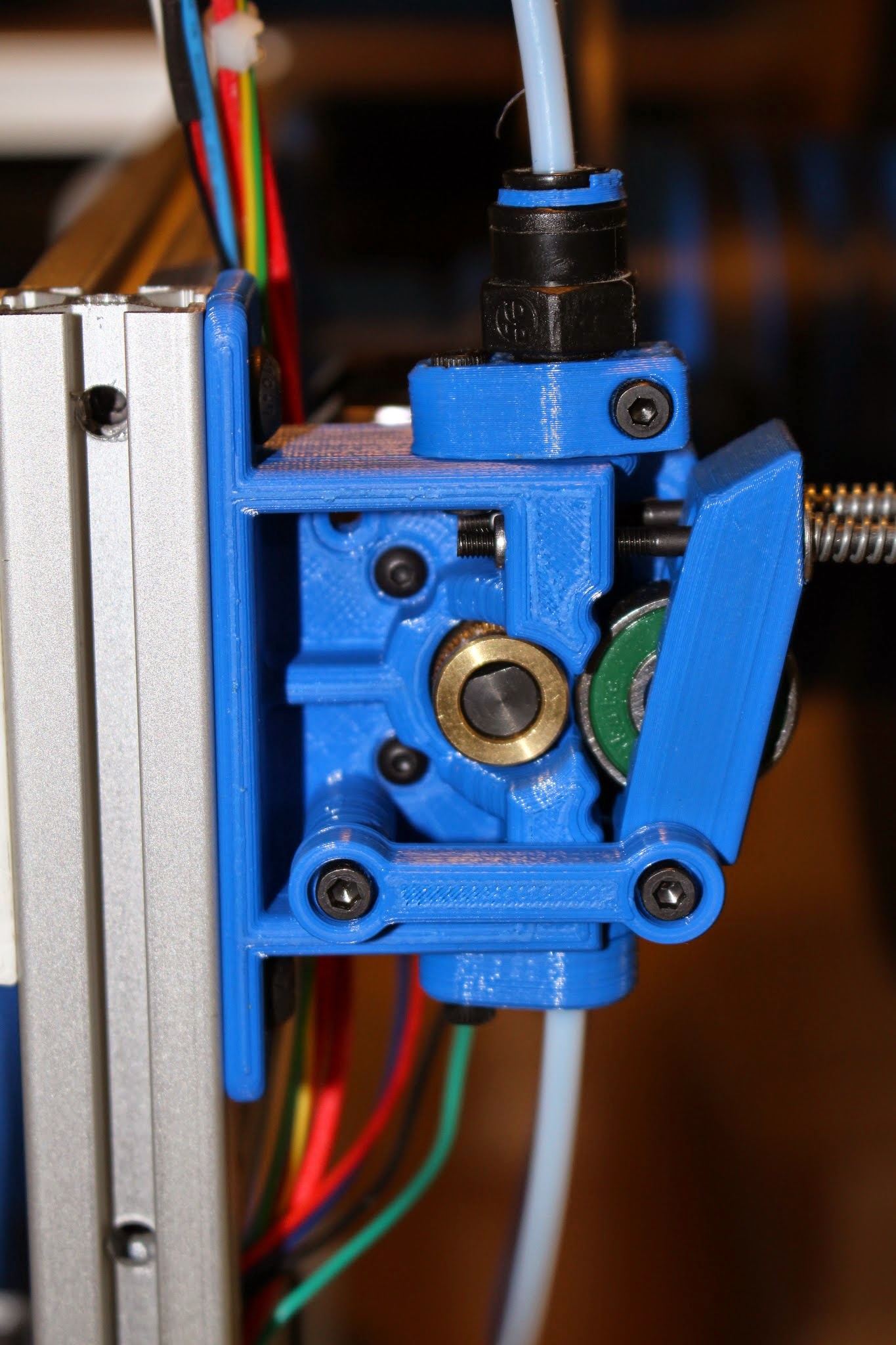

Finally upgraded my extruder to @Eclsnowman 's hurcustruder. The difference is night and day! I can now start a print and leave. No fiddling with the bed to make sure the plastic doesn’t jam. Planetary stepper just powers through. I also quite like the filament spool mount. Only complaint is that it’s much harder to change the filament.
I took the time to re-enforce my hotend (It could move slightly along the Y axis, resulting in some ribbing) and actually mount the printer board to the printer itself. I’ll eventually do the same with the PSU.
I printed a 30mm test cube, 0.2mm layer height, 40mm/s inner perimeter, 20mm/s outer perimeter, 50m/s infill. It’s alright; nothing really spectacular though. I would like to get those faces super smooth though, even at 0.2mm. Any suggestions on how to improve this?

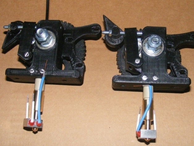

@Erik_Scott I have a “bird nose” on my classic Greg’s Wade’s pusher. It allows me to set the tension and then quick release whenever I need to inspect the gear teeth or change filament. Then when I put it back in place, then tension is exactly what it was before. If I’m going PLA to PLA, or ABS to ABS, I don’t need to mess with it at all. Something similar here would probably solve this problem.
@SirGeekALot I agree the quick release lever is a must have for this type of extruder. It allow quick disengage of clamp without touching the spring tension. So always back to the same compression after filament change.

Weird, I failed to find “hurcustruder” via google… Where do you get it?
I need to discard my own one (that fails with a speedy 24V delta) and I was currently looking for an alternative…
@Eclsnowman Doh! Should have gotten the spelling correct. It was late when I posted so that’s going to be my excuse. Thanks for the positive comments though!
@SirGeekALot do you have any pics of your extruder? I’m looking for ideas on how to possibly add a lever to more easily change filament.
@hon_po I have indeed calibrated my E steps, and I seem to be extruding the right amount. Off the top my my head, it’s about 480 steps/mm. @Eclsnowman , does that sound about right for a 5.18:1 geared stepper?

@Eclsnowman good, I’m in the right ballpark then.
@SirGeekALot thanks for that. Seems pretty clever. I may give it a shot.
