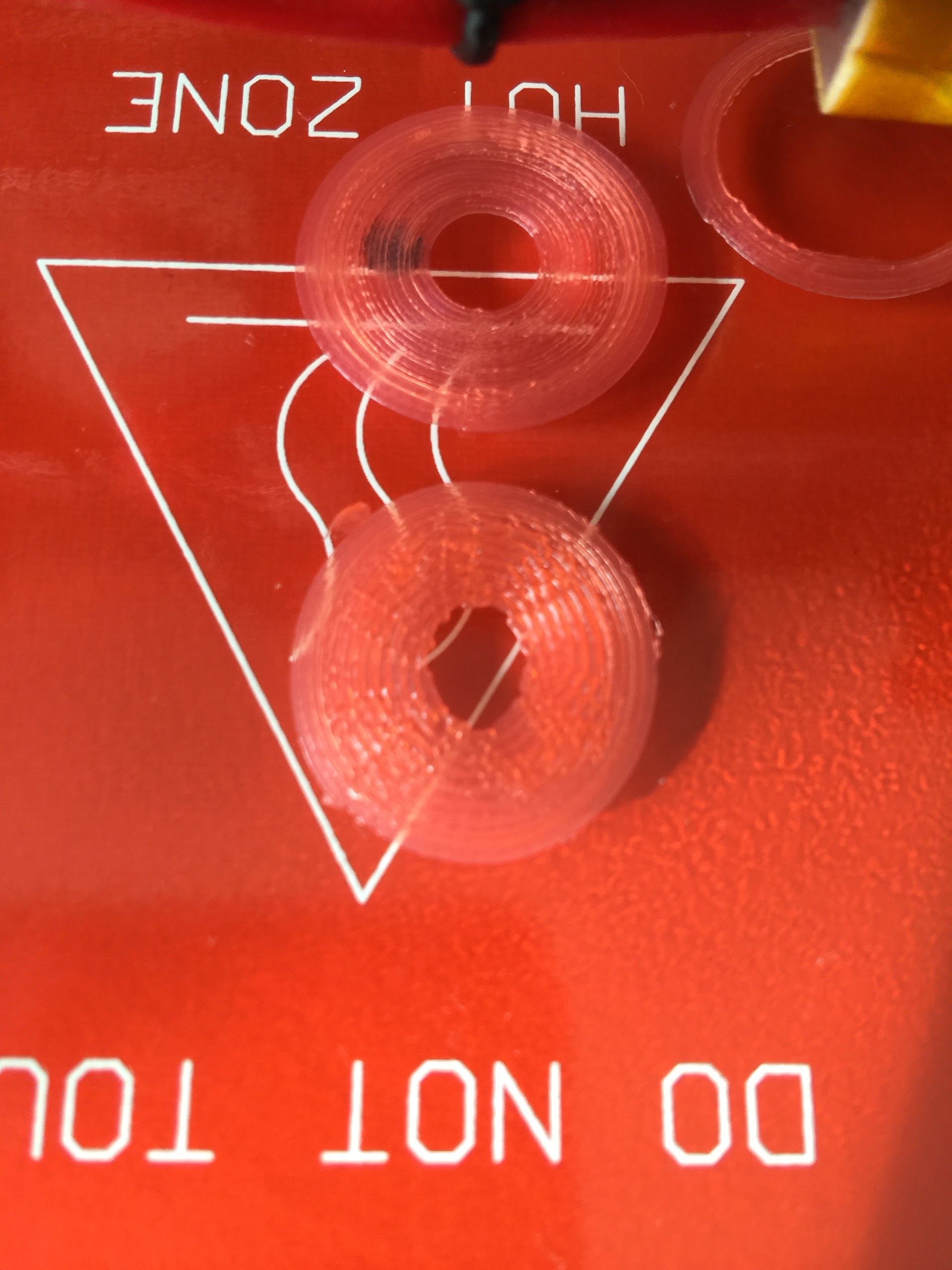

Finding my brims a little stuttery and inconsistant.
Finding my brims a little stuttery and inconsistant. Signs of other problems in the setup?? Prints are going well but I’m a complete noob only had my china special (geeetech i3 X is the closest model I can find by looking at pictures of the frame and extruder etc) I haven’t made any changes to the settings using cura to slice and printing from prontface. 1.75 pla @ 185 end / 60 bed
That usually happens when your nozzle is too close to the bed for your first layer
Currently setting my bed by paper although I guess that depends on the thickness of the paper!
Ha-ha paper should be okay… I personally use a feeler gauge (between .25-.30mm gauges) and then set the z- home to -0.28mm. There are a lot of ways to measure/calculate the initial z gap though…
Ok that’s not a problem I can bring some home from work to set the height. One thing I have noticed is that when “home” my bed moves too far through the machine and comes off the bed a little. Not a big problem as I haven’t tried any big prints yet but the micro switch has no adjustment so will have to figure something out to correct that!
You have manual leveling correct? With the four screws on each bed corner
Correct
What I would do is use a G92 offset in your start gcode. You can mess around with your starting height without the tedious paper method. You could use it temporarily or forever. Basically it keeps you from having to adjust all the screws. Just a suggestion.
