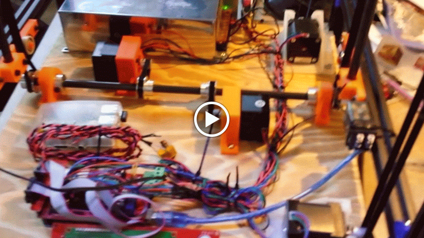

Fine. Here’s the Z-stage thusfar. esteps = 158.39177 Reference voltage at 1.4v (but since the motors don’t move much, there’s no thermal cutout and the motors don’t get hot.) The drop test is with 900g worth of Chili.

Getting closer. I had to give up on the glorious 13"^2 glass build plates…the motors couldn’t lift the build plate (without anything printed.)

@Mike_Miller put a geared stepper on there and you could gain esteps and lift the glass no problem.
Yeah, probably. Don’t have a spare $60 for that at the moment. I’d want to figure out something other than the GT2 belt, too…pretty sure that would be the weak point then.
As it is, the aluminum rod was deflecting with just one pulley and motor, the second lends a hand in lifting, but also keeps the mechanism in alignment. I had two really nifty idlers mae with the @igusInc rod, but didn’t need them with two opposing forces.
You could, in fact the ingentus does just that, but I wanted precision over cost when there was a question between the two and machines aluminum wins that contest. I also wanted the inherent noise absorption that you get from timing belts. You can get awesome ground worm screws, but things get less certain when you’re buying cheap Chinese screws (and not German).
