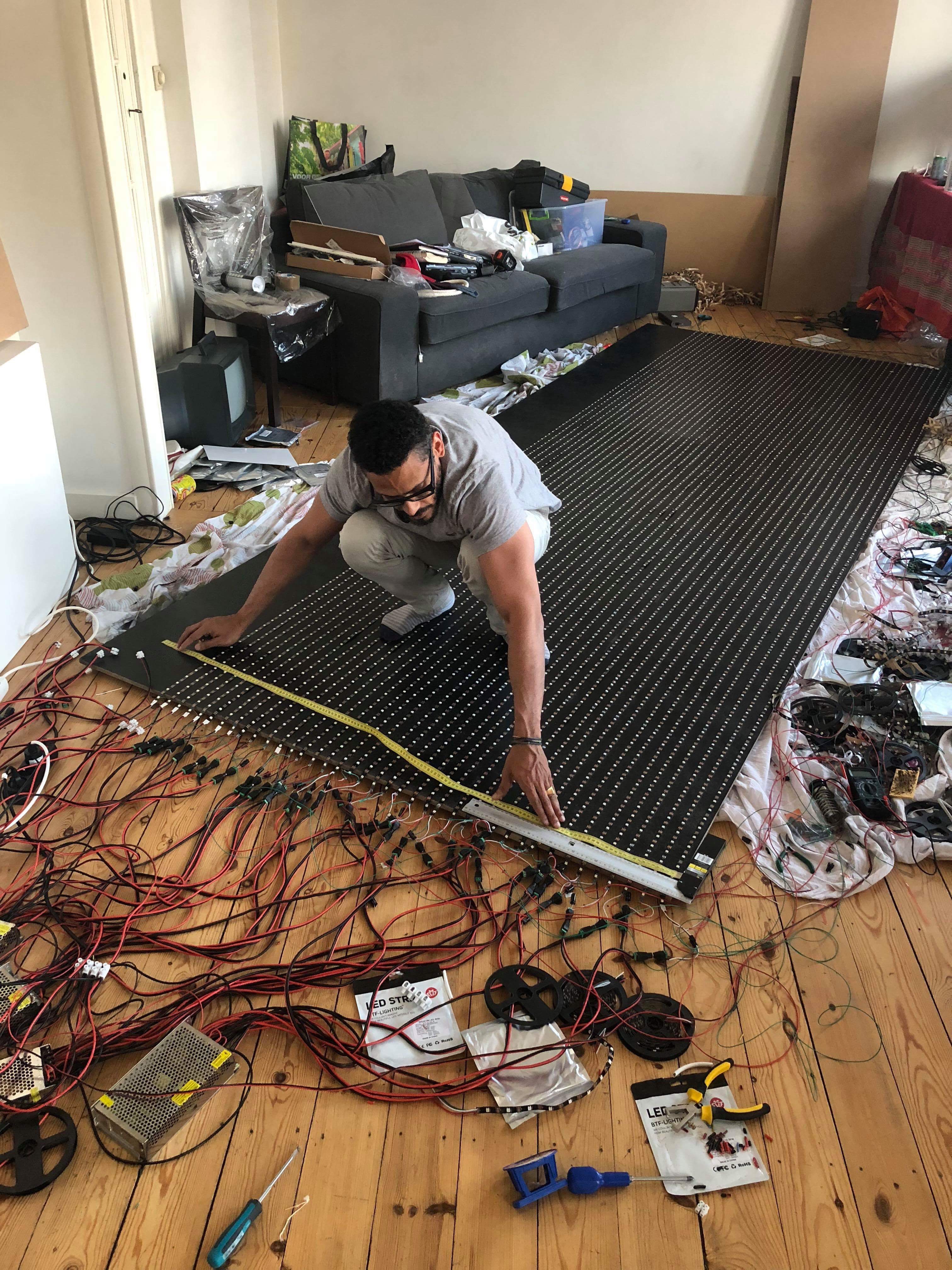

Finished !!!! 5904 leds. 16 pins parallel output on eps32.=>82fps.
Finished !!! 5904 leds. 16 pins parallel output on eps32.=>82fps. I need to clean up the code of the FastLED library.

What did you use for the backing material?
Simple 1.8cm chipboard that I have painted missing/deleted image from Google+

Very cool!! Where are you going to mount it? And how are you planning to mount/conceal the power supply wiring/etc?
@Ryan_Cush all the power and data wires will be stuck behind the board. It doesn’t show clearly on the picture but the strips are longer than the board of two pixels. So they can ‘wrap’ around the board. The panel by itself will be mounted like a white board on wheels. So I can move it easily. It will go against the 4.5m wall of mine living room.
That must be crazy bright, I guess you only run a very restricted brightness! How many amps does it draw?
@Will_Tatam maximum 360A (6000 leds x 0.06A) if I go white full brightness. I have set up for max 64 in brightness and I never go full white hence theorical max draw 90. But I have 6x40A power supplies. Theorically I could push the brightness to 170 but then I will need sunglasses lol

@Yves_BAZIN I’d guess you need a different backing to spread the heat at full power too.
@Thomas_Balu_Walter indeed. I have tested letting the panel open for 6hours in a row, the power supplies on open air? They are really ok you can touch them. When order them i received couple of them with fan integrated and it makes a big difference. I have received a new power. So stuck all this on a metal plate to help heat distribution and of course keep a good distance between the panel and the wall.
