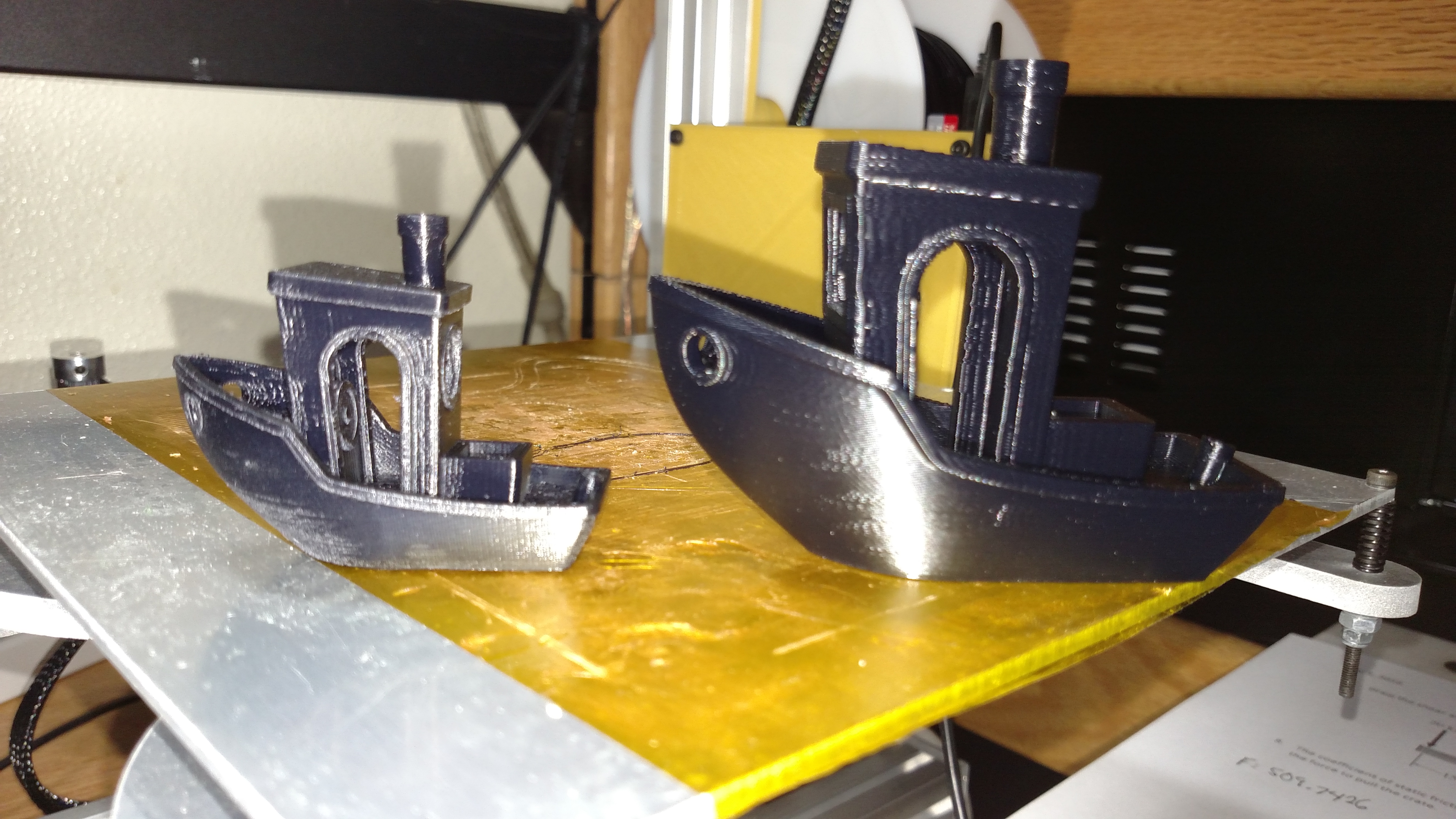

Finished doing a few benchy prints.
Finished doing a few benchy prints. On the left is a standard size benchy printed at .05 mm layer height and on the right is a 150% scaled benchy printed at .25 mm layer height.
You post this here to get some feedback, don’t you? I know, that z-steps of 0,05 are difficult and your prints look already very good. But, you need to work on ghosting / ringing with either stiffening up your printer or reducing weight on the printhead or declining the acceleration-settings. And the bow of the smaller ship looks like either the bed is too hot or the hotend is too cold. But I think its the bed. On the bow of the bigger ship you have some ‘zits’, maybe the easiest way to fix this is using “inner perimeter first”. But this will probably solved by adjusting the k-factor aka advanced-mode aka coasting.
