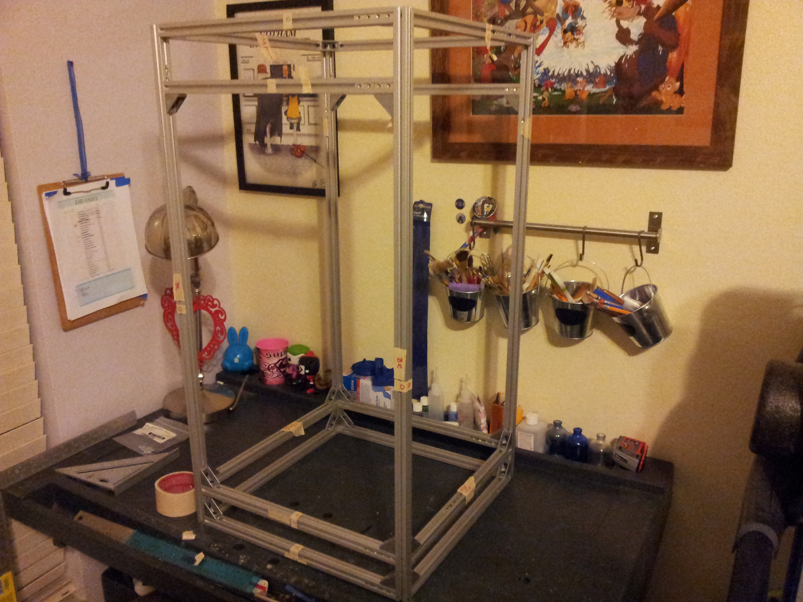

Finished for the night. Tomorrow I finish aligning everything.
Where can I find the assembly instructions on the V2 Spider? Or the ones for the Herculein(the gantry instructions should be similar…I hope)
Thx
Thx
None are written yet. But I would love some help in this regard.
@Eclsnowman
Even thought mine is a variant, I could create instructions as I go. From the drawings I can’t tell if the 8mm rods supporting the hotend have to be put in the same time as the 10mm x&y rods. Can they be inserted later by slightly spinning the support arms
On Eustathios the side carriage 8mm holes are deeper than needed. So the cross rods can be pushed into one side deeper than needed, then the other side rotated in, then the rod pulled back.
@Eclsnowman
Excellent, thanks for the info.
