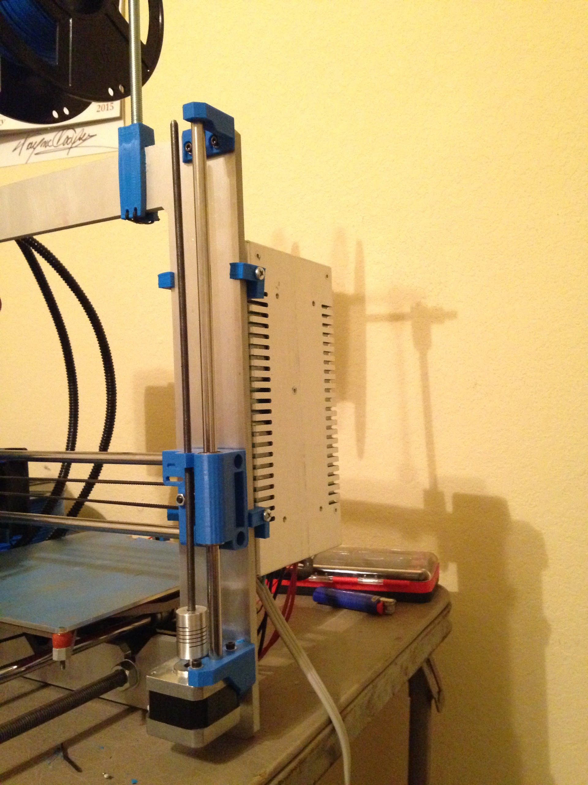

Finished how I wanted it I didn't add any stabilizers.
Finished how I wanted it I didn’t add any stabilizers. I’m happy but no switch for the psu. Need a box or something I can make for it

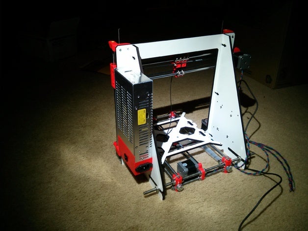

This is the PSU box I designed for my i3
Hey thanks. That’s what I was looking for :wink:

All aluminum frame, Ramps 1.4, e3dv6 with .4 nozzle, lcd 12864, 80mm cooling fan for ramps, 2x 40mm cooling fan (one for hotend one for pla cooling), autobed leveling (haven’t started that yet), spool holder, aluminum heat bed with mk2. I bought a digital dial indicator and printed a mount I found on thingiverse for fine tuning the axis adjustment. I ended up with a spare e3d (the volcano is on my list). I accidently burnt the arduino voltage regulator somehow during the build so I got to fix that (don’t wanna disconnect all my purty wires). Then eventually if I wanted there’s some holes drilled where I COULD box it…
