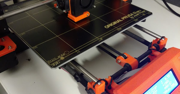

Finished my mk2 Took me 3 hours to tune the frame to pass calibration,
Finished my mk2
Took me 3 hours to tune the frame to pass calibration, and it still isn’t perfect, but was able to print the frog. Was testing something taller, a vase, but the filament came undone 4 hours in. I think it was a tangle? I have to check when I get home. Had my kid turn the printer off.

Yeah mine says it can’t detect front points. I said oh well print! Almost got all 3d printed parts reprinted in black. Couldn’t get the orange. Need to print a new spool holder if you haven’t yet. Print bearing clips for the bearings under the bed too, they slip with just zip ties. Dab of hot glue is a simpler fix. I used dreylin bearings for everything.
Oh and i hated the glue stick it came with. Switched back to my disappearing purple one

Going to go around and really tune the frame.
@Vaibhav_Goradia ​ it was back ordered and took a few weeks to come in.
That’s what i used to tune mine! Check out aaron yourk on tinker cad he has some nice parts
Yea I did, but was afraid my printer is too out of wack to print the guides correctly.
