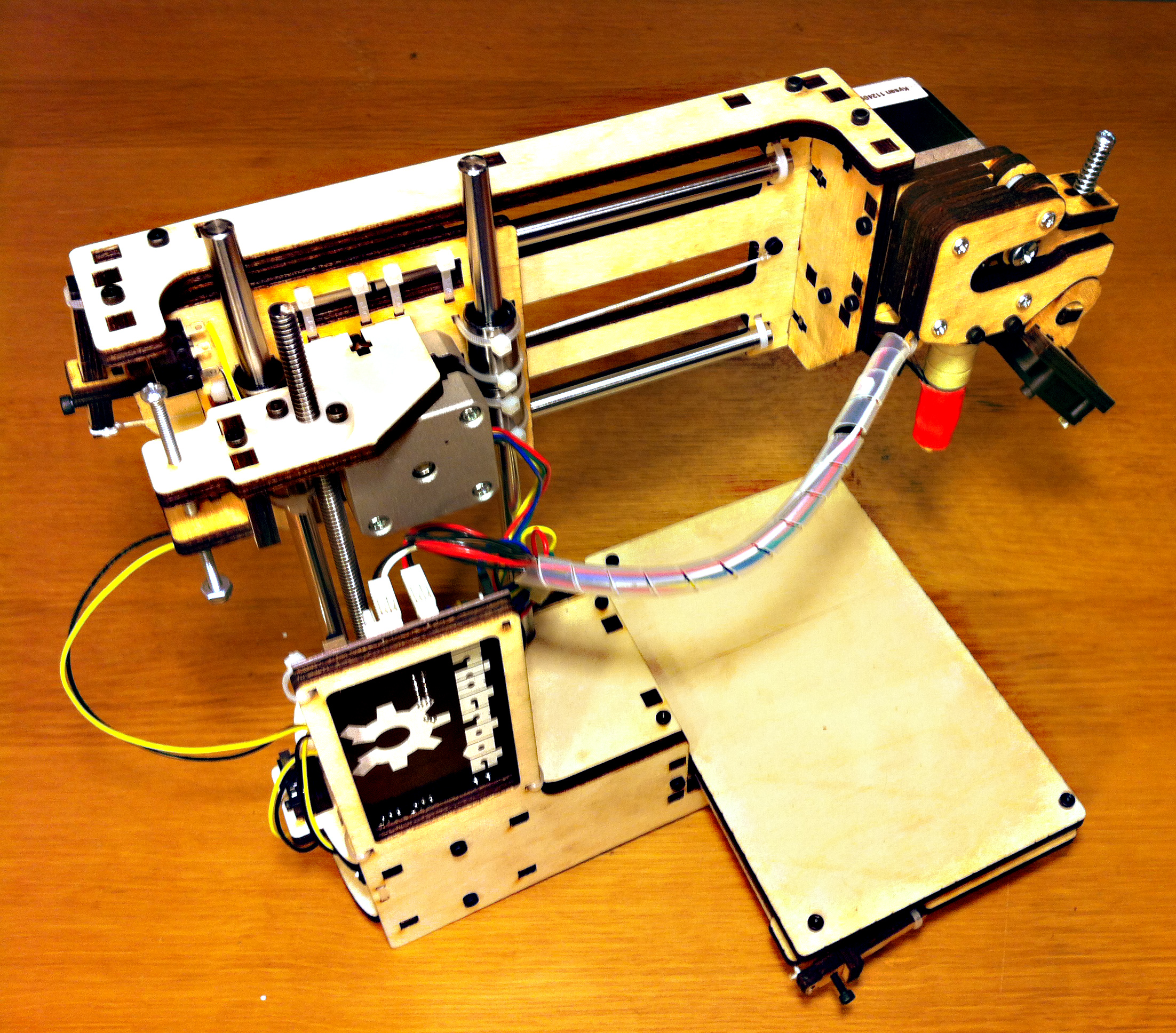

Finished the build! And yes,
Finished the build! And yes, I’ll remember to use some painter’s tape on the base! I have it somewhere. Any suggestions on super easy guides for getting drivers and all up and going on Windows - or is the one provided by Printrbot the best?
Originally shared by Andrij “Andrew” Harasewych
Well, now to figure out the firmware and software situation with getting this guy to print… but otherwise ready to go with my PrintrBot Simple Kit!

That looks a pretty as a sales photo! Nice job.
The supplied drivers work fine on my Win-7 netbook, and Repetier-Host / Slicer (the download PrintrBot points to) is a great start.
The 3 things that made a big difference for me were:
-Put a piece of glass on that bed (put tape on the glass). I used regular window glass, and it’s worked fine for several weeks.
-Once you get a decent print, print some knobs for the bed leveling. Makes bed leveling MUCH easier. I used these: http://www.thingiverse.com/thing:103519 -Use one of these guides to help prevent filament jams: http://www.thingiverse.com/thing:163249
Good luck, and enjoy!
@Carlton_Dodd Thanks!
When leveling the bed use a business card. Move the head to the four corners and makes sure the business card barely catches between the head and the bed. It takes a few times around to get it nice and level.
I am using repeiter and slic3r. If you are using the pdf on the printrbot page they will walk you through set up. If you see a command waiting in your manual positioning there is a solution in the same pdf, just scroll down.
Take a look at my galleries on the Simple. I do lots of calibration with a digital caliper
