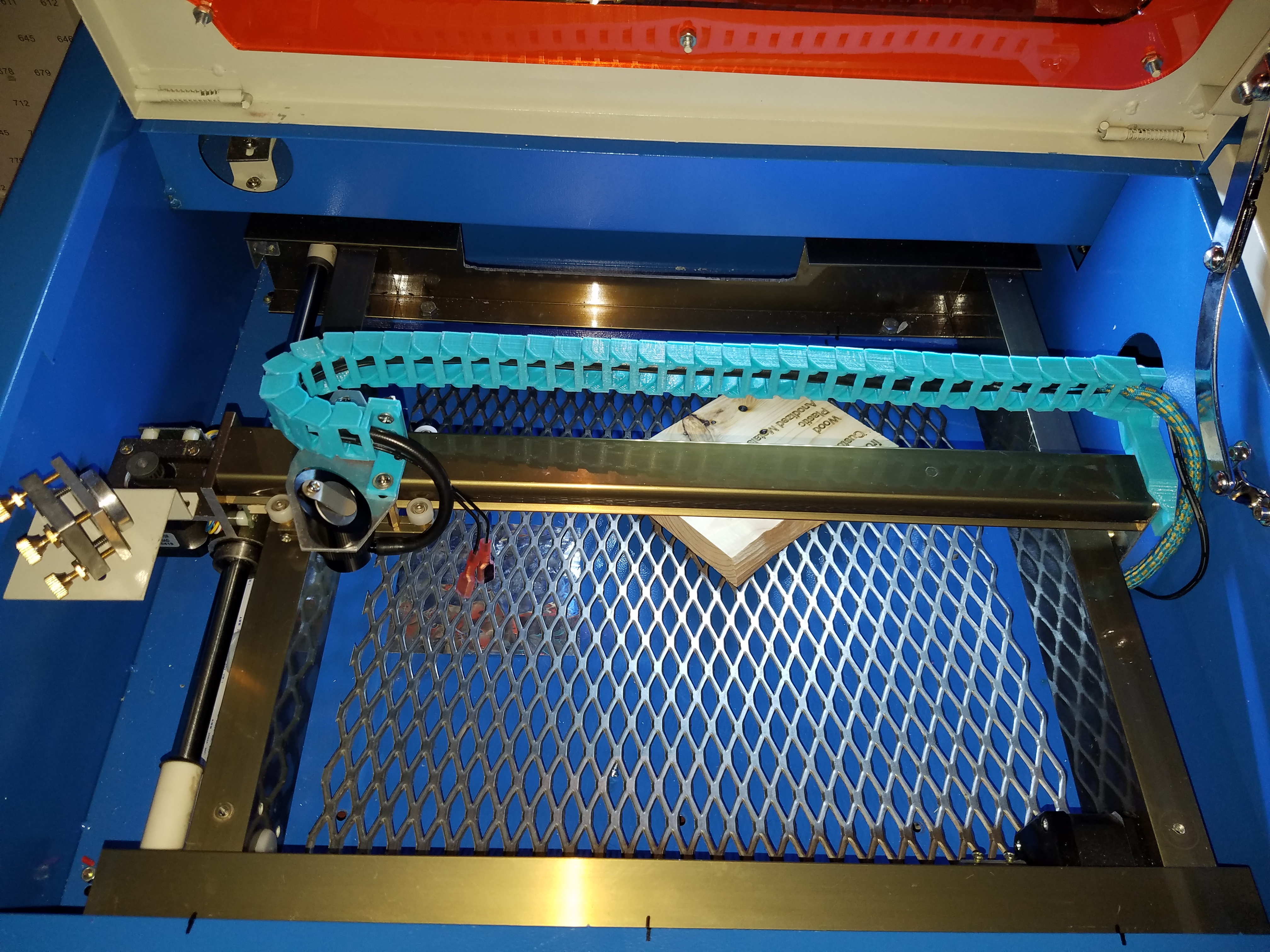

Finished the cable chain and getting the new light objects head and lens in.
Finished the cable chain and getting the new light objects head and lens in. :slight_smile: Took a while to find a soft enough hose to run through the chain, ended up cutting up one of my air brush hoses that have a fabric shell, super soft tubing and pretty tough as well.
Where are you routing the air out of the machine?
That looks excellent. Really nice job!!
@Alex_Krause through the hole in the back it came with. :slight_smile: And thank you @Daniel_Wood , it definitely took some fanaggaling haha.
Here is a link to the thingieverse file I used by the way http://www.thingiverse.com/thing:1275013

Vent cut and back in, and finding focal point of lens.
Mine is over the top, and there’s a second one on the side that goes to the back of the enclosure.
@Ashley_M_Kirchner_No that is neat, I have a hinge on the right side that hangs all over, I like how it looks over top though, very cool.
