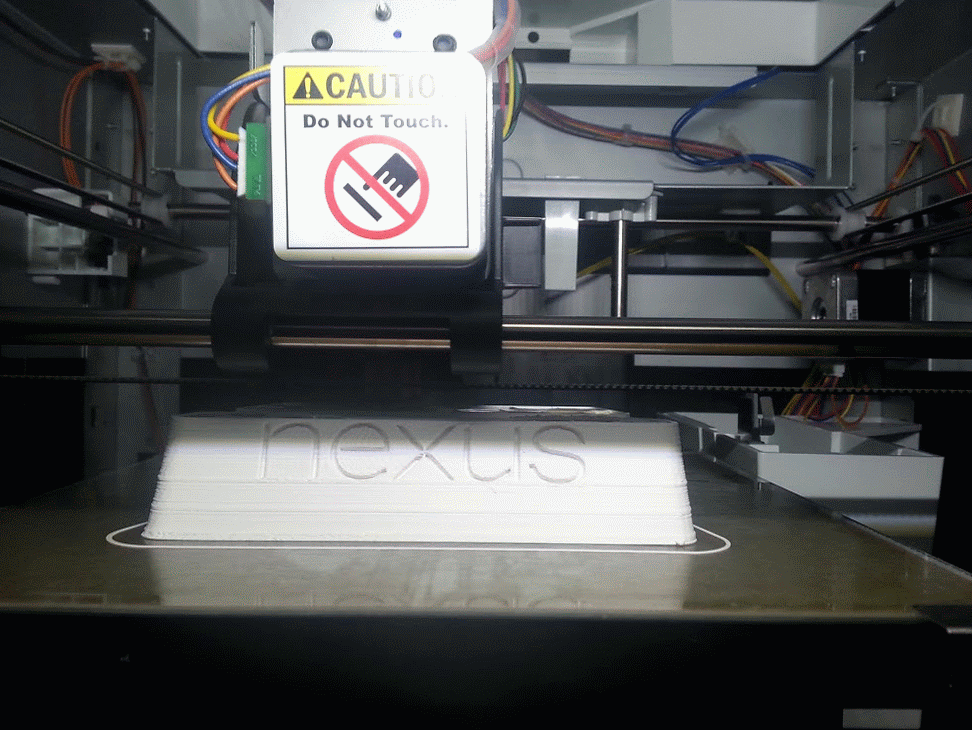

Finishing up my first print on my xyz da vinci.
Finishing up my first print on my xyz da vinci. Nexus 10 pogo charger dock. .2 mm thickness, medium density, normal speed. Looks like I will need some post production sand paper.
Try an Acetone Vapor bath instead of sand paper! it’ll give it a glossy finish, and remove all the layering marks. you will need a large glass jar (like a cookie jar) and regular acetone (paint Thinner) Heat the acetone in the jar until you can see it begin to condensate along the upper area of the jar. Place your printed object on a metal pedestal above the liquid acetone. I can usually fit the jar on the heated bed, and use it to heat the acetone safely. then you can watch it happen… and it Does happen relatively quickly (Minutes). Suggested Temp for Acetone 180 C.

Good to know! Any tips for sanding? This is just cheap abs.
I once tried sanding, useing very fine grit sanpaper, but it left the plastic fuzzy, and dull looking, So I then tried Emeory cloth in extra fine grit, and while the plastic no longer looked so Fuzzy, the finish was still dull and muted.
That’s awful! What’s your layer height? Looks like at some regular interval, there’s a rounding error that’s causing layers to be over-compressed and smoosh (that’s the technical term) outward.

I use Dremel for finishing. You can both send and polish to get glossy appearance. Acetone vapor bath might be quicker and sometimes gives you better results but you have to be aware that acetone vapor can be explosive so I avoid it.

Also note, turns out my software and firmware were out of date on my printer. just did a update going to print some more, see if I can get those slicing errors and rounding errors reduced!
@Crystal_S_UnStuckInL yes. Just that glue stick.
After my firmware and xyz software update. The printer seems to be printing faster and more accurately. But im just doing simple end caps now.

@Whosa_whatsis Every single Da Vinci I’ve seen has those artifacts in the prints… including the samples from their own site. It boggles my mind that they didn’t even try to fix that prior to releasing this to the market.
