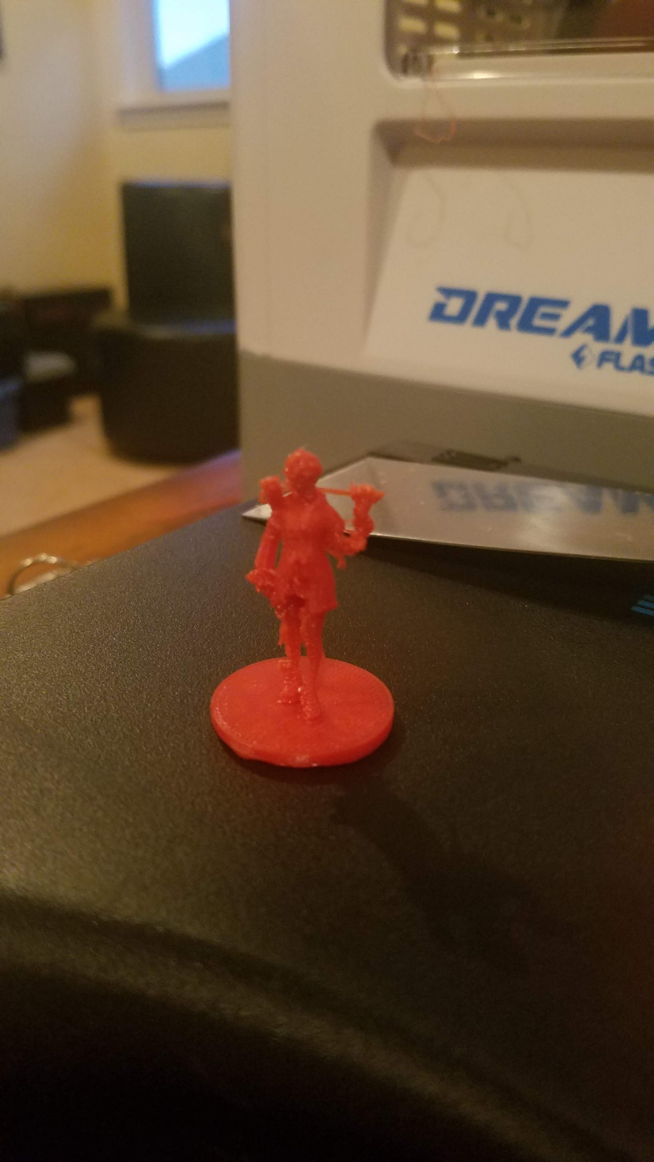

First 3d print. Using Flashfore Dreamer and Flashprint softwere. Any suggestions?
For a first 3d print it is preatty good. You’ll have a long road to make. I would start by lower temperature or lower speed or both. Good luck.
I would try with lowering extruder ratio with 5% and raise retraction plus presure advance if you have similar option in software or firmware.
