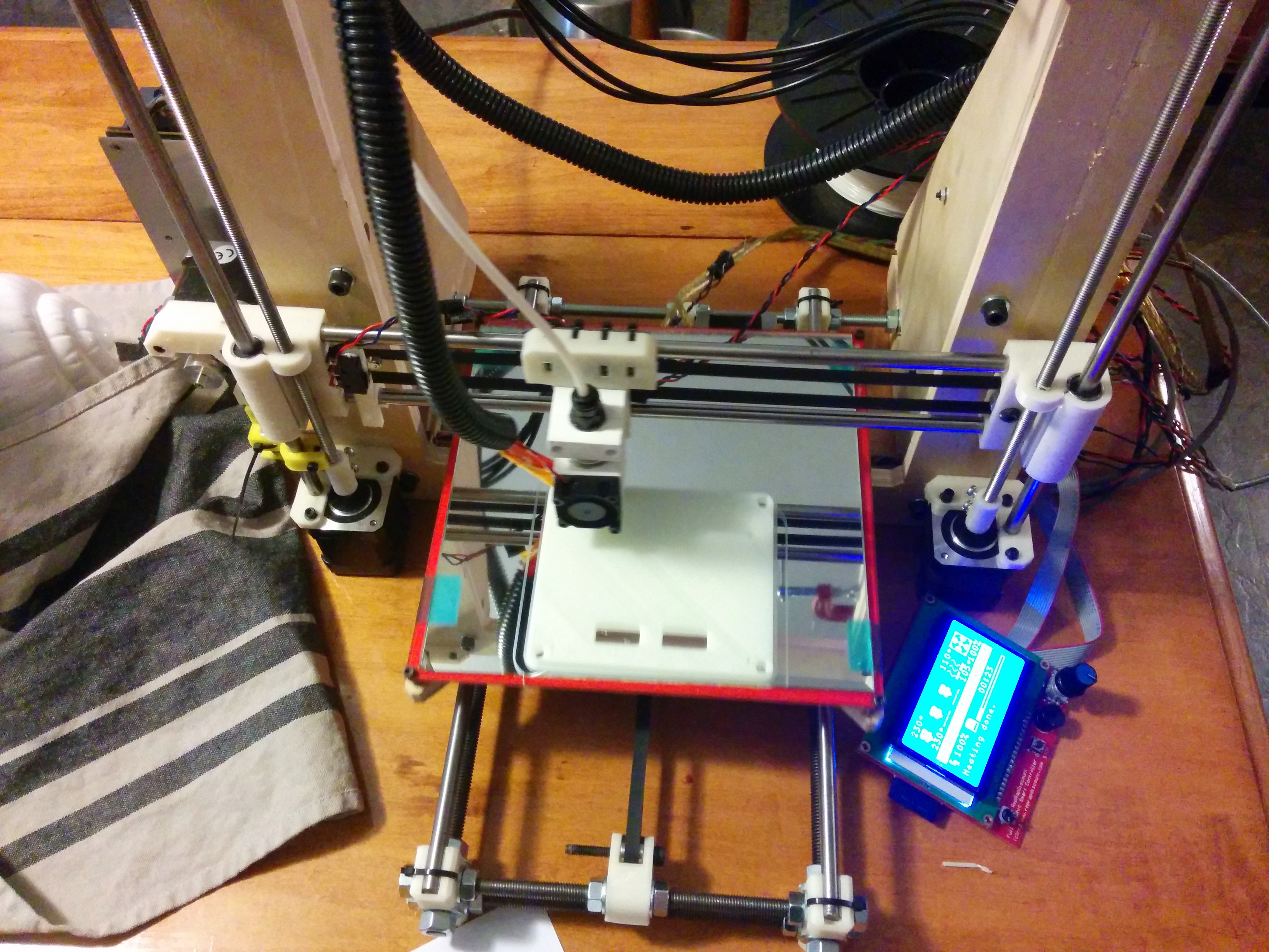

First Abs Part off the cheap-o chinese electronics. Worked pretty damn well shockingly.

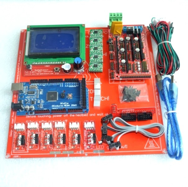

First Abs Part off the cheap-o chinese electronics. Worked pretty damn well shockingly. Took a few hours of tweaking pin values in the firmware to get encoder working right on the LCD and you have to write firmware with the USB they came with. But you cant argue 63$ ramps kit that comes with a bed and the big LCD and 6 endstops.

looks like you are printing the back of the LCD case. It came with the mirrored bed glass?
Thats the kit. Its dropped a dollar since I ordered it.

I keep waiting on a 32bit Chinese smoothie kit with lcd to pop up. I would take a plunge to try something like that.
