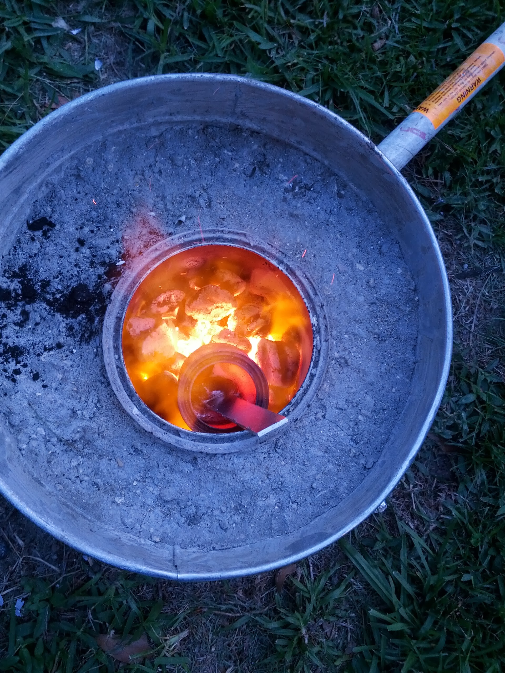

I used a small paint can as a crucible, worked great. You want something with thin walls, the length of 2" steel pipe with an end cap I tried I couldn’t get enough heat into
  • the walls need to glow red hot!

@ThantiK Your absolutely right that the shorts were an unsafe idea - but that picture is actually from an early firing, where I was just creating some ingots. It’s a lame excuse, but I did wear pants and boots when I did the large pour into the mold a few days later. I’ve read up on the safety risks, and the largest one seems to be concrete’s tendency to explode if exposed to molten metals (only occurs if it is the slightest bit moist.)
@Heath_Ebert - I did an earlier post on general construction of my furnace, but basically an air mattress blower connected to a conveniently sized length of broken pole vault pole is coupled via aluminum foil to a 2" long, 1.5" length of steel pipe. The pipe goes from the outside of the larger steel bucket, through the quickcrete, and into a standard paint container I bought new (and clean.) I plan to eventually try gas, but for now about 10 charcoal briquets provide ample heat to get the smallest sized paint can crucible glowing red hot. I have been melting aluminum scrap from work, as the # of cans and the crud from their coatings make other sources a pain.

@Chet_Wyatt - the thing does get pretty hot during an extended run, and will likely wear out, but as I don’t plan to use charcoal forever I haven’t worried about it. They are designed to run for at least 5 or 10 minutes against a gradually increasing pressure gradient I’d imagine. And thanks for the tip @ThantiK !
