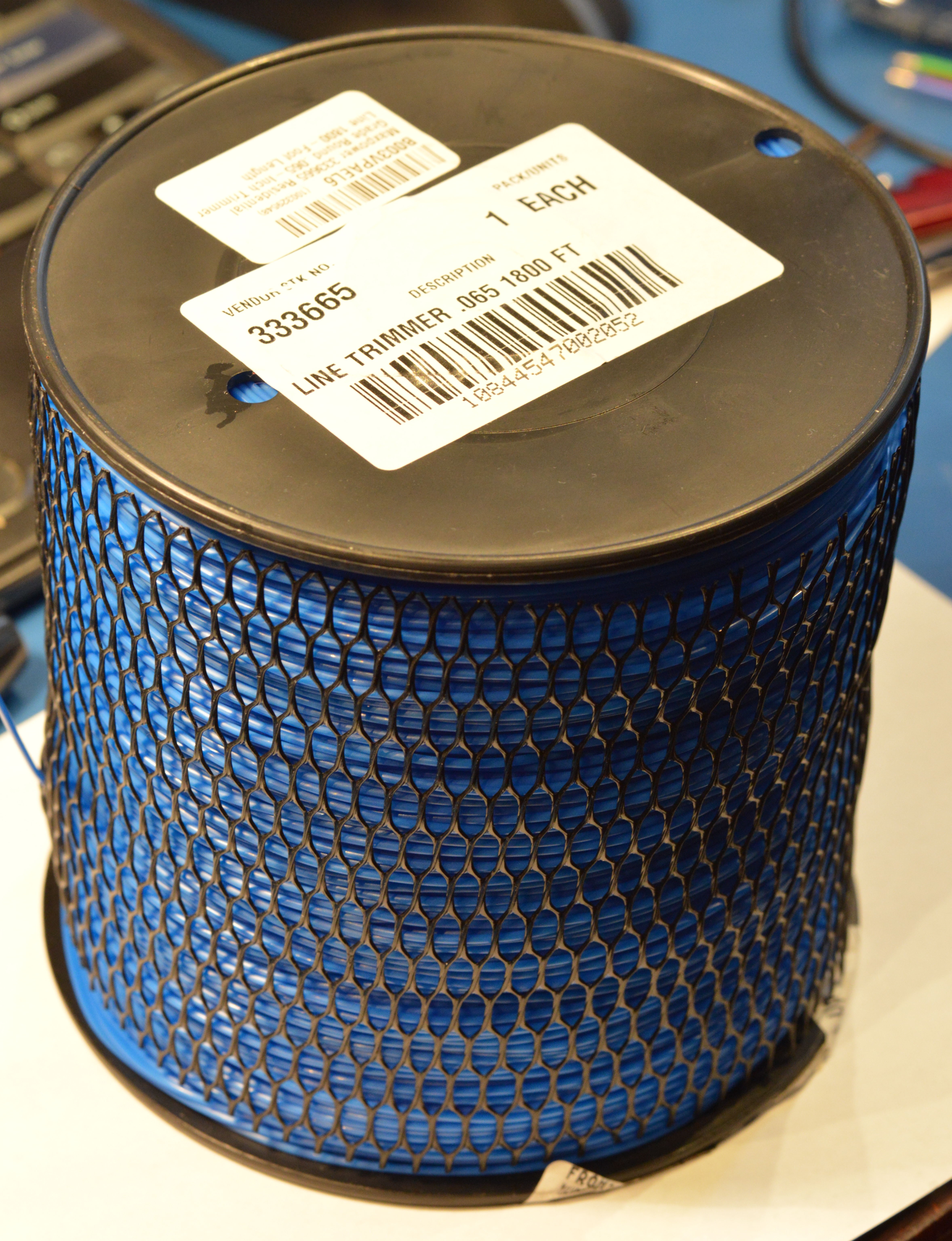

First attempt to print Nylon trimmer line. Got 0.065" trimmer line.
Got 0.065" trimmer line. This is about 1.6kg material for about $22.
Dried a couple of meters in the oven at around 150C for about 2h to get the water out.
Extrusion settings with filament diameter 1.67mm and 245C temperature. No heated bed, just painters’ tape (it does not seem to stick properly on glass or on glue-stick). There is a hardly noticeable plastic smell while printing. Good enough to sit right next to the printer without being annoyed.
First results look promising, but shells always work well anyway. It seems material swells a bit, need to play with that.

Yes, @Mark_Rehorst ; some spot-checking showed that the filament varied between 1.665mm and 1.670mm, so pretty close, but have to do some more thorough checking with more measuring points at different places some meters apart.
Can you provide the source for the trimmer-line please? I’d really like to try to print nylon myself, but i’m discouraged by the high prices of nylon filament for 3D printing.
@Lars_Bohm : I got this from amazon http://www.amazon.com/dp/B003VPAEL6

There is 0.095" Nylon trimmer line (so, roughly 2.4mm), that fits into 3mm extruders, @Richard_Mitchell .

Taulman Bridge is definitely the way to go to have predictable results known to work for 3D printing @Richard_Mitchell . I was just curious what I can do with off-the-shelf material which is not meant for 3D printing, and it looks like it could work.
(Though I’d prefer if it was just white or black, not some random blue color).

I have printed about 100lbs of this exact trimmer line. It’s pure nylon 6. The manufacturer is Desert Extrusion out of Arizona.
It’s truly fantastic filament, but it must be dry when printed. It can re-saturate in <24 hours too, so keeping it dry is a chore. It can hold >10% of its weight in water. Ideal extrusion moisture content is <2% and >0.4%
I’ve found it to be very consistent throughout the spools (+/- .03mm)

Oh and RE: the color, the reason it’s blue is that most mfg typically color code their diameter. IE, .065" trimmer line is blue, .095" line is orange, etc.
Black and white would definitely be nice, but the blue is a good color, and it takes dye well if desired.
