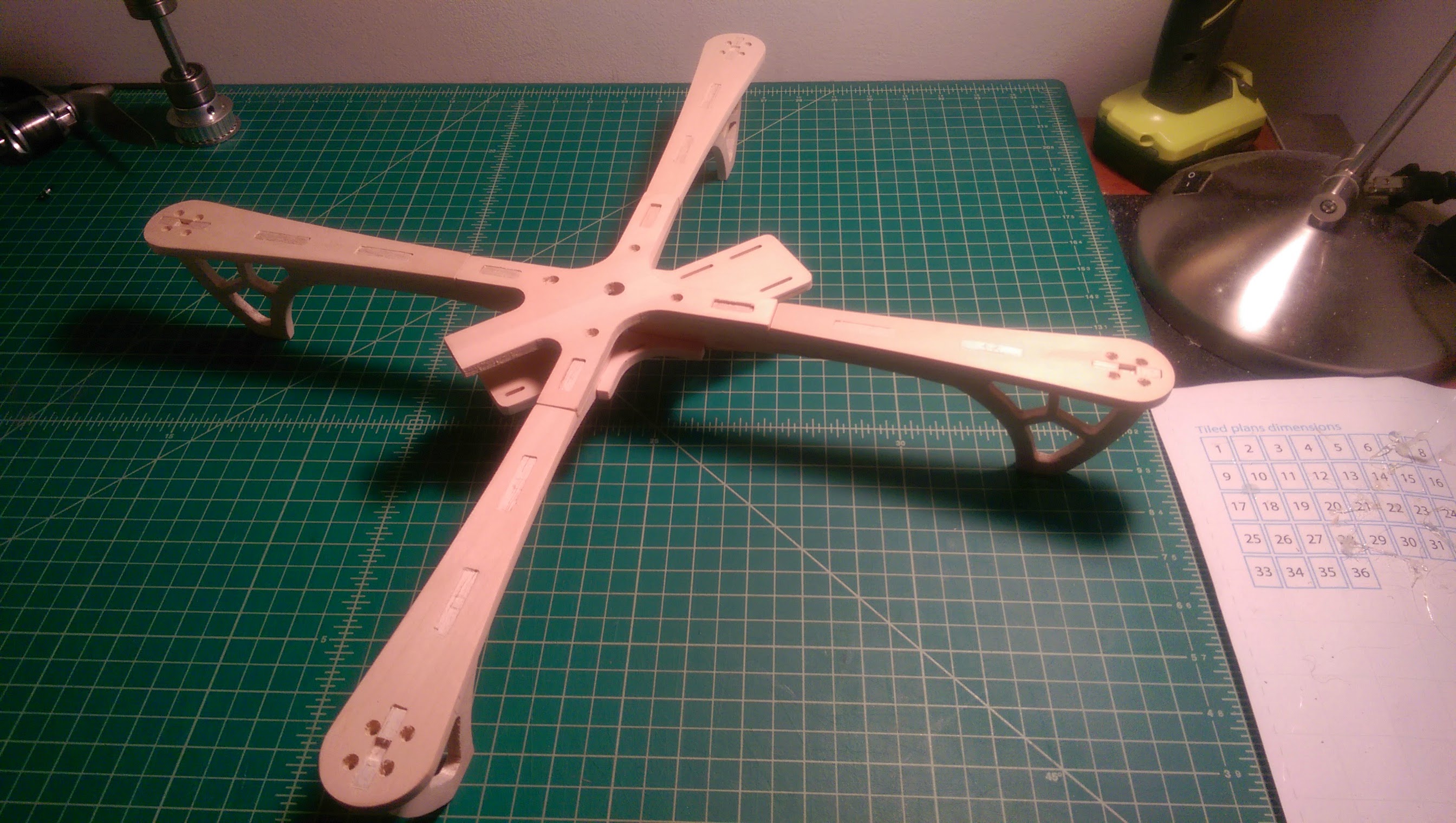

First bigger project with stock shapeoko 2 except for a new dremel. 1/4 ply for everything except for the landing arms.
That looks great!!
awesome. what software/toolchain did you use? any lessons learned?
@javierymirna Thanks! Hopefully it flies well.
@Frank_Graffagnino Both CAD and CAM done in Inventor HSM 2015. Universal gcode sender to drive the Shapeoko.

Hello, Nice work. What is that surface that you set your work on to take your pictures?
@Britton_Evans thanks. That green thing is a big cutting mat
