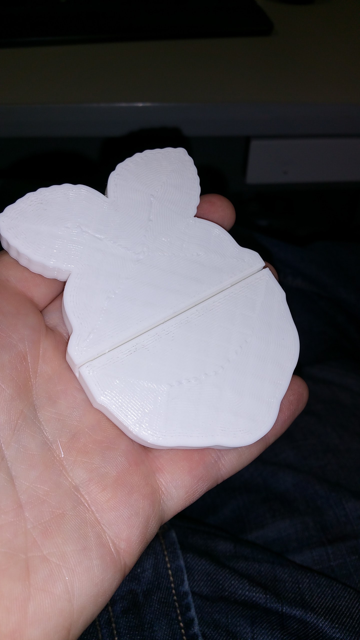

First calibration print had me adjust flow to 0.97, then printed this off. Really happy. Minor stringing to be tuned out. Layers show some contraction at the base. Maybe too much heat on the bed. 210C at the nozzle and 60C on the glass.
Not sure about the general layer inconsistencies. Fist time using hatchbox filament…maybe diameter issues.
